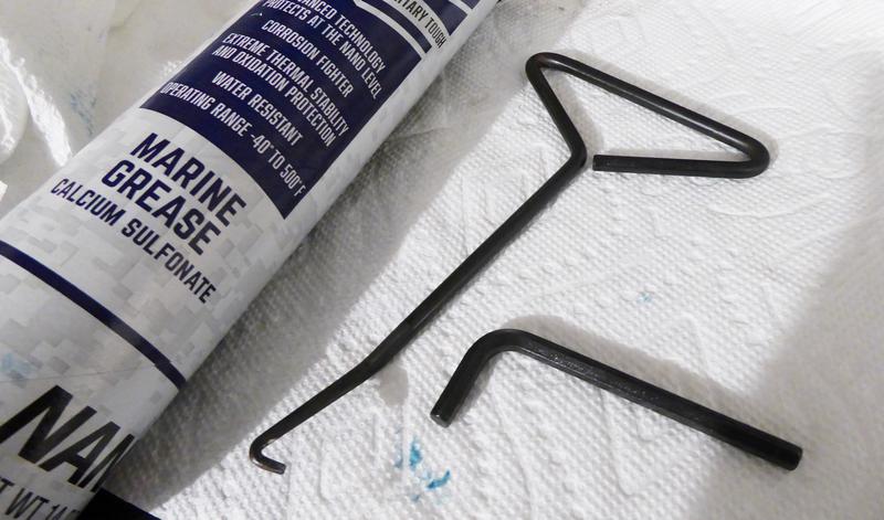

Tools needed:
Waterproof grease
5mm allen wrench
Spring Puller

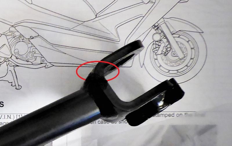

Apply plenty of waterproof grease to this pivot part....then slip one of the rubber O rings onto the recess slot at BLUE arrow.
Slip the other rubber O ring over the stand here (trick Robot used on a Vespa stand)
Place the stand on the scooter, push the greased pivot pin through, start the threads, slip the (red) O ring off the stand onto the pivot pin. Tighten with the 5mm allen wrench.
Hook the spring onto the arm on the frame - secure the scoot from falling off of the center stand - pull the spring onto the stand arm with the spring puller.
