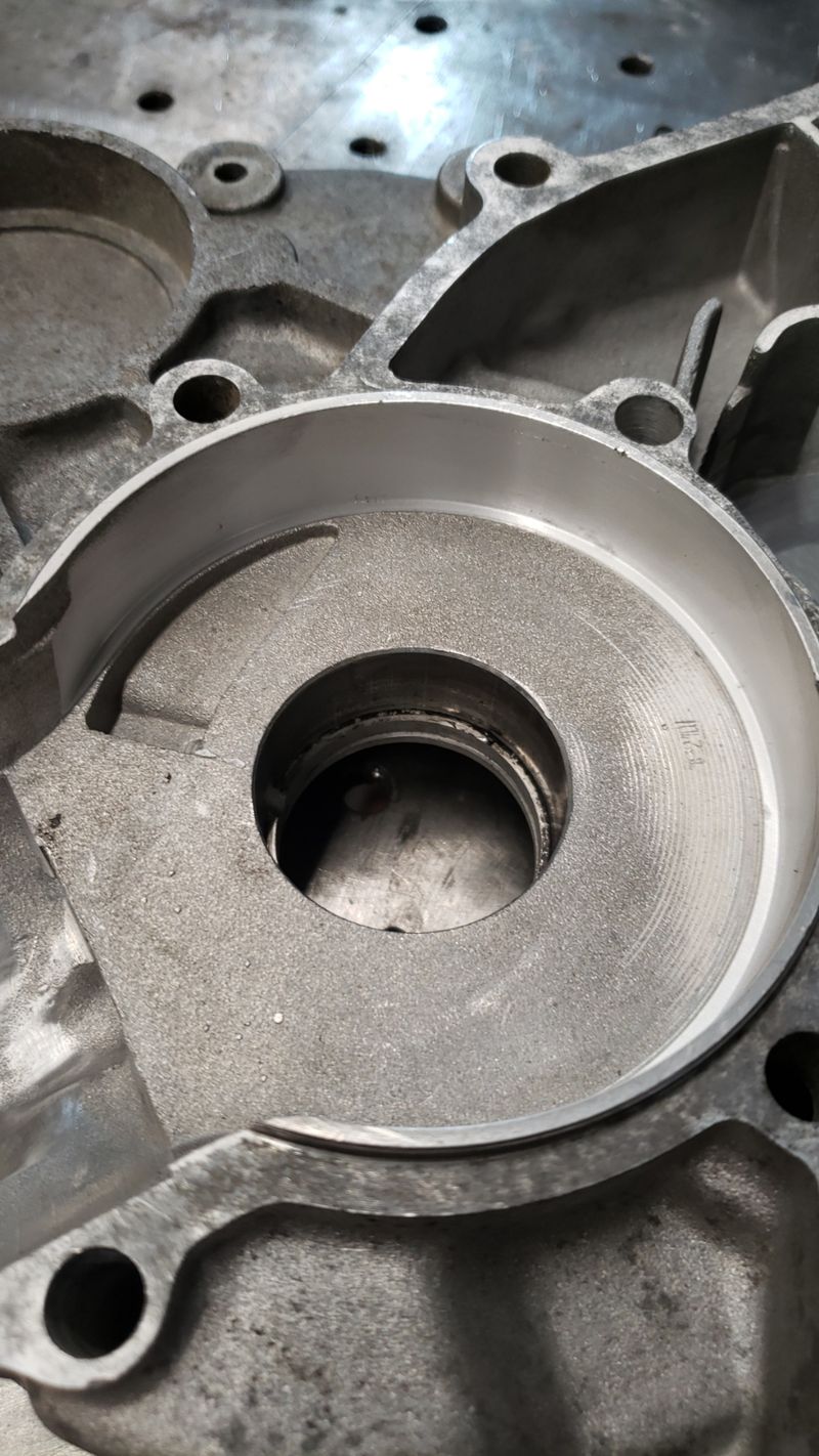

And after the machine shop did their work. They were having a slow afternoon, so the father son duo started on it right away. About 40 minutes later I had the cases back!

Mon, 09 Mar 2020 04:07:05 +0000 quote
That is definitely some great work and no going back once you Mill out the case for web. Love that you hit a road block and just fix it with solutions that I would be terrified to try. Keep it up!

Wed, 11 Mar 2020 19:11:49 +0000 quote
hibbert wrote:
Dude that is some nice work. Nice job on polishing the rod could have fooled me looks like it's supposed to. Nice job on decking the cases money well spent.
Thank you hibbert. Ideally I would to have loved to split the crank and polished the whole connecting rod, smoothed and polished the "window" in the web, and grind in an oil channel into the lower end of the con rod (the upper already has a small oil channel). I have a local guy who does all that work for a VERY reasonable rate, but he has a very bad shoulder right now, so I don't want to bother him. He also balances and welds up the crank pin too! He once built me an incredibly awesome T5 crank about 5 years ago. The engine was virtually vibration free.
Money is always going to be an issue for everyone, but if I'm paying for something that is high quality, then I don't mind. I figure more as an investment, rather than just "throwing money at it".
And I forgot to include an "after" picture of where the crank area was milled out so that the 53mm long stroke crank can now fit.

Thu, 12 Mar 2020 01:00:55 +0000 quote
was wondering where that photo was looks beautiful
