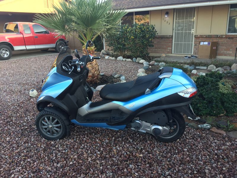

I know alignment has been discussed a zillion times. My MP3 "walks or tracks" at slow speeds. Front end wanders or perhaps follows imperfections in pavement. From my formula ford days I have a hunch it's toe setting. Scoot has been dropped at least once.
I have not seen this specific problem on here before.
Advice?

Holy crap. Fixed!!!! Just did the quickie move the bearing fix. It took 10 minutes a side. As soon as I did left side the centered steering notch went away. Did right side. Greased the heck out of both sides with a grease gun and drilled bolt. Took it for a ride: completely different scooter.
Now just need to put all the plastic back on. Thank you to all of you for your help! New Bearings will go into storage for full replacement if notchiness comes back.

those tyres aren't that michelin Gold ?
