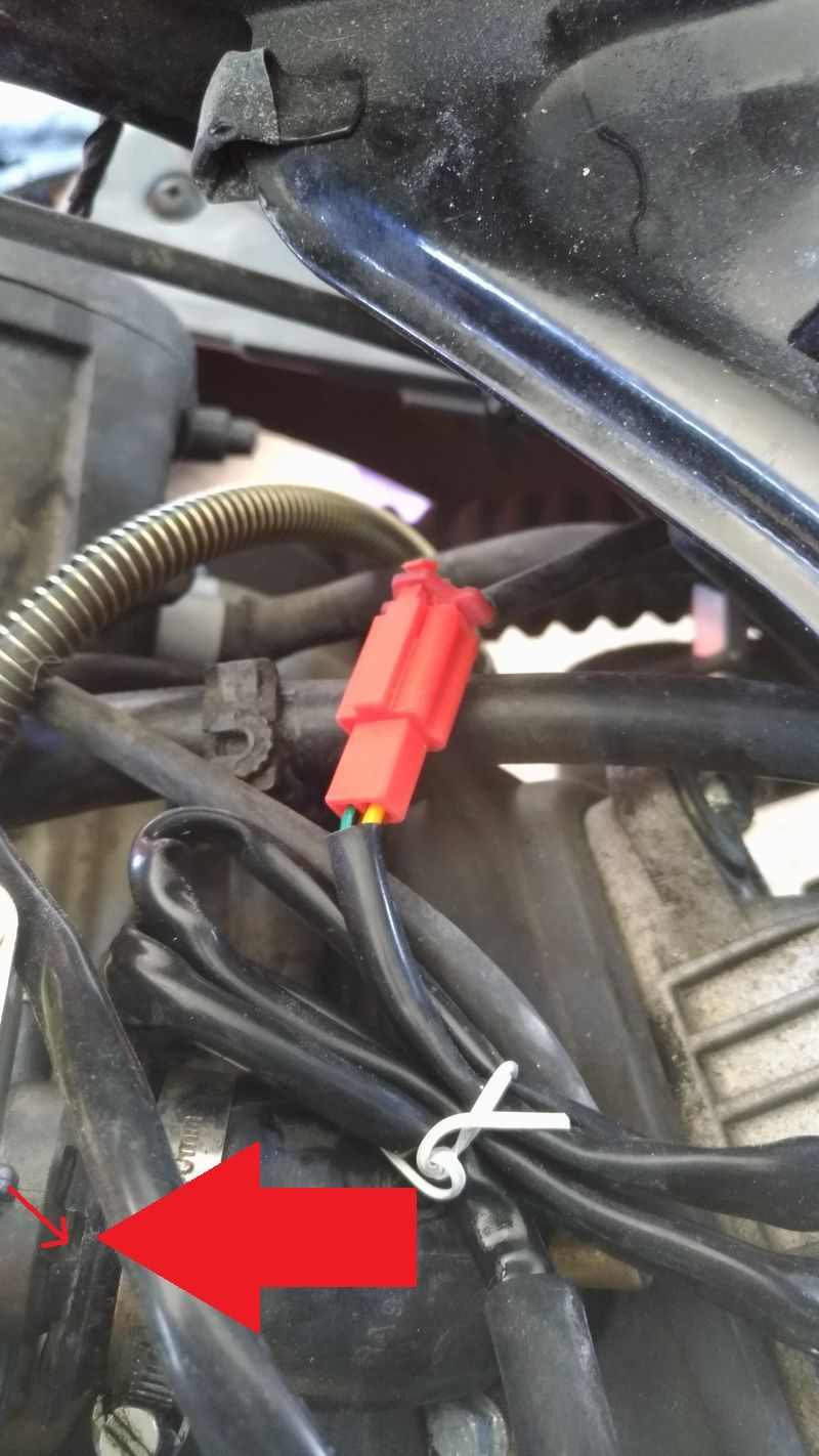

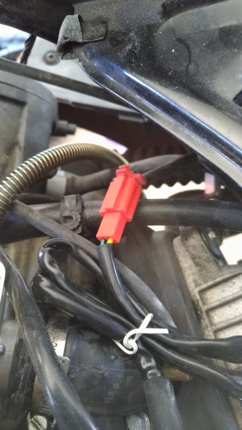

Checked the carbs electrical choke and no current coming in

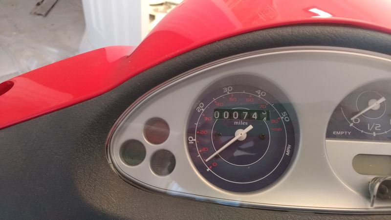

Is this 74.3 miles or 743?

That's 743 miles, few enough that I don't think valve and compression problems are very likely. From the story so far, I'd be more inclined to suspect a fuel delivery or electrical problem.

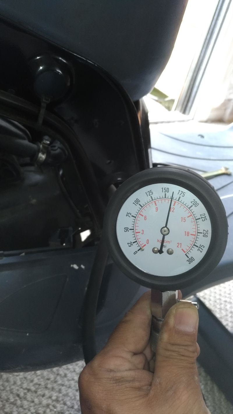

Okay I put a compression tester on this and I'm getting some 165 PSI. So I think it's something else now. I know I'm getting some Sparks on a spark plug. Anybody chime in what to do next thank you very much. I need to put a new carburetor on it so I can get it out of the equation.

This beauty will start one day. I still think it's only got 74 miles.

The speedo says 743 miles.

Carb isn't fully seated in the intake manifold...

Thanks all. I will try all those and fix seating my carburetor

I want to thank you all for being so patient with me. I finally got my Piaggio 50 fly to work. I replace the coil even though I Can See Spark but I guess it wasn't quite strong enough even though it's a blue Spark. The scooter really runs Smooth. I got it running up to 30 miles per hour without adjusting anything yet. I hope I can get up to at least 40 this is a nice 50cc for a stroll type of travel. I would not try to make it regular Street Rider till it starts to keep up with the traffic. But it's still a pretty bike. I want to thank you all for helping me diagnose this and I hope I can help some of you later on down the line. I love this website and I hope it's keeps on helping. And it is 750 miles or so and not 75 like I said I stand corrected. I thought had
Tenths on last digit.
