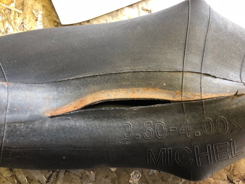

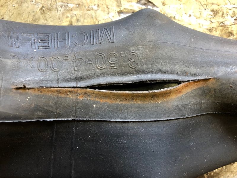

I put 2 new Michelin tire and tubes on my original split rims last summer. I rode the whole riding season then parked the bike in the garage for the winter.
Pulling it out to take a quick ride during a mild day I found the rear tire nearly flat.
I simply aired it up and went on my way. Shortly afterwards I noticed it again low on air. This time it wouldn't even take air.
I figured I either picked up a road hazard or the dreaded pinched tube. As you can see from the photos it was the latter and it was pinched in several places including the complete slice shown here. To think I rode an entire season on this makes me shutter.

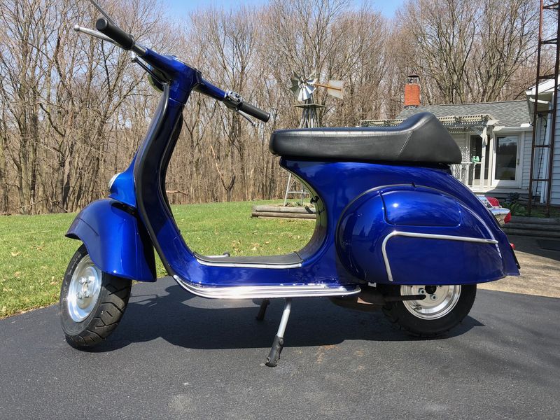

Not wanting to deal with this any longer I decided to move into the 21st century and install tubeless rims and tires.
There must be a reason that the majority of automobiles on the road today all run tubeless.
Yes, I realize that tubeless tires can also go flat. The spare on my Stella was one of them. But I feel it still offers many advantages over the tube type, split rim system. The technology is there and I took advantage of it.

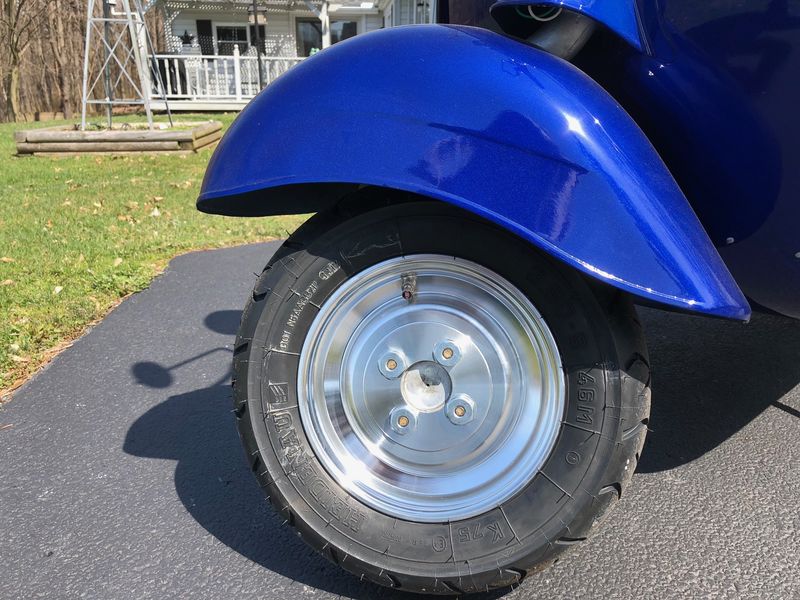

Up dating to the tubeless rims and tires was an adventure for me and a learning experience as well, but all worth it in my humble opinion.
These rims are available from SIP which is where I bought them through Scootermercato.
They are available as rims only or you can get them with a new tubeless tire, (several to chose from), already mounted. My brother choose to buy them with tires mounted where I opted to buy just the rims thinking I would install my nearly new Michelin tires on those new rims. Bad choice.
First of all, from what I now understand you can not mount a tube type tire on a tubeless rim. So using my next to new tires were out of the question. Secondly, it seems trying to buy a 3.50 X 8" tubeless tire in the states is like trying to buy unicorn horn polish and thirdly, its almost impossible to find anyone willing to mount a 8" tubeless tire.
Knowing all this I had to once again go back to SIP (through Scootermecato),
and buy 2 new tubeless tires. The exact same tire, (Heidenau K75, 3.50x8"), that came mounted on my brothers rims.
Then I went searching to find a shop that would mount them. I got lucky and found a Good Year Tire Center 7 miles from home that said they would mount them, no problem.
All said and done I ended up paying the same as what my brother paid for his 2 mounted tubeless tires with the same polished aluminum rims which was $250.
I believe my two rims were $130, the tires were $90 and mounting was $30. That all adds $250 not counting shipping in either case.
So my advise to anyone who wants to go this route is to buy them with the tires already mounted and be done with it.

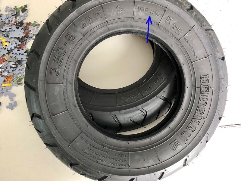

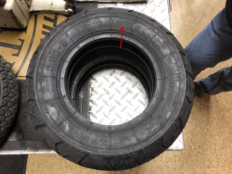

Not all Heidenau K75 3.50-8 tires are the same. Two were ordered from Amazon and the tires were clearly meant for tube type installation. Below is a photo of one of these tires and "tube type" is shown printed on the sidewall (red arrow). These two tires were sent back and two were ordered from SIP. These Heidenau K75 3.5-8 tires were "tube less" and this was shown on the sidewall (see photo blue arrow). It is best to use a tubeless tire on a tubeless rim. In the case of Heidenau, be careful you get the tire with "tube less" printed on the sidewall.
In a perfect world, yes slightly inflating the tube helps prevent pinching the tube in a split rim situation. But pinching can and does occur in these cases as well. There is no question in my mind the tubeless tire/rim setup for 8 inch wheels on a classic Vespa is the better approach. They are much safer and should you get a puncture you can get it plugged with the tire on the rim just as you can with automobile tires.
Heidenau K75 3.5-8 "tube type" tire.
Heidenau K75 3.5-8 "tube less" tire.

In respect to what was the difference between the "tube type" and "tube less" tires? First of all I did not have the two different tires here at the same time to compare, so I really can't say.
I had ask this question on several forums. Many said the difference would be in the bead. I can't attest to this personally.
What I can attest to is that I wasn't going to mount a tire that was specifically marked "tube type" on a tubeless rim.
These tires are listed on the SIP site as TT/TL which I take can be used either way. Perhaps they dropped the Tube Type line and consolidated them into one type, who knows. But the tires they sent me were clearly marked "tube Less" as the photos above show.
The same tires I bought state side were marked "Tube Type".
