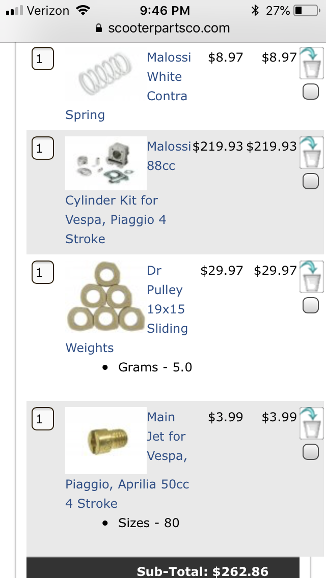

I picked up my 2006 LX 50 last June and asked the same questions. And I got the same "buy a 150" from multiple people. I disregarded their suggestions and instead decided to pursue mods. I started with the Malossi variator. It's performance was marginal at best. I tried a larger carb jet. No change. Then I ordered the Malossi 80cc kit and Malossi cam, which I installed myself. Huge change. I no longer worried about being able to accelerate from a stop, and the top speed of 45+ MPH is ample. The good thing about your scooter is that it's a 4 valve so you don't need the cam. In fact my wife has a 2014 Piaggio Fly 50 (same 4 valve engine you have) into which I installed the Malossi 80cc kit, Malossi variator and size 80 main jet. Her scooter accelerates event better than mine.
Last fall I decided to mess with the LX and installed a Malossi kevlar belt, and opted to throw in a set of 5 gram Dr Pulley sliders (with the stock variator) while I was in there. I'm not sure if it's any faster, but the engine is much quieter on acceleration. The Malossi variator is very rattley (is that a word?).
So my suggestion is to purchase the Malossi 80cc kit, 5 gram Dr Pulley sliders, Malossi white contra spring, and a size 80 main jet. It will cost in the $300 range for everything, and it will wake up that scooter.

Actually under $275 shipped to your door.

I don't see how any of the stuff mentioned will increase the speed. Acceleration and hill climbing maybe but speed not really. Unless the lighter weights allow the engine to rev a bit more.
No cam shaft?
Looks like another post to justify someone else's purchases. without any factual proof of performance increase.

No factual proof? My LX 50 had a top speed of 37 MPH, and it took a half mile to get there. Now I get my 230 pound body up to 40 MPH in under 20 seconds, with a top speed on level ground of 47 MPH (GPS verfied) in a quarter mile. Anybody is welcome to come take a ride to see for yourself.
And what I meant by no cam required is there's no high performance cam needed for the 4 valve because the stock camshaft will suffice for 80cc.
