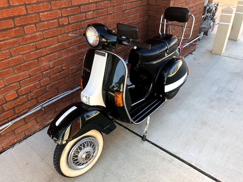

After some coordination on my end I managed to trade my 1.25 scoot's (1964 Allstate that was up for a full resto and 1980 Rally 200 rusted out frame and small bits) for a 1979 P200e. P has around 7.7K miles on it and is a solid runner with a need for some small TLC to make it to my liking.
Plan is to run her this season as a daily (1st year of full on commitment to ditch my car as much as possible) and hopefully pass the 10K mark. That being said couple questions arise:

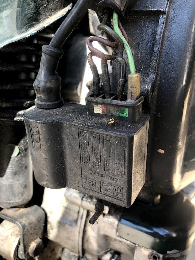

1) CDI has a yellow wire that has deteriorated....is it ground? Do I need buy a new CDI at this point if the scoot runs good?
2) Neutral light does not work...big issue?
3) Gear oil change: whats size washers do I need?
4) 3rd gear skips occasionally while running...1/2/4 are solid. Will oil change help or I need to adjust the shifter cable?
5) Last item: plan is to have the scoot rebuilt after the season is over. What is the best paint/clear that you can recommend so I start looking at colors and options; I used Eastwood in the but I am wiling to look at other brands...
Photo(s) attached.
It's a ground. you can replace the CDI.

The CDI can also be saved. You have enough wire on the old CDI to dig it out and solder a new one on the stub.

From the photos, it looks like a good paint job now, why repaint?

Jack221 wrote:
If you are lucky the 3rd gear jumping can be saved by fitting a new gear selector box. Make sure you buy the old PX type, as any other will still bolt on but not work correctly. You are still going to split it at some point anyway but when you do you will still need a new gear selector box, so no money wasted.
https://www.sip-scootershop.com/en/products/selector+box+old+px+for_87034000
Thanks for the link. I was thinking that it might be next item on the list.
CDI: good point. I will save what I can before buying new...
I do agree in photos it looks good...after looking around I might just match a "touch up paint" color and cover the bare metal spots/scratches.
Thanks for the suggestion!

brolsk2 wrote:
No, man. Do what I do. Cover the scratches with beer stickers.
