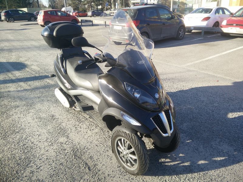

I've got a slightly modified Givi windshield on my MP3 250ie. I dont know it its because the previous owner shortened it, its designed that way, or something is broken/missing, but its insanely wobbly at highway speeds. It annoys me a lot.
I've ridden a few MP3s with Givi windshields, if fact i dont recall ever riding one that didnt have a givi windshield, and i've never noticed this on them.
I've removed and refitted the windshield a number of times without any improvement. I'm looking at creating some sort of support like the OEM large window has. Anyoen tried something similar?
Member basiegel68 has pictures of the windshield i'm talking about. Piaggio Factory MP3 Medium Windscreen

got a set of bracket laying here
ohh, tell me more! I wasnt aware there was a bracket for the givi windshields. I had resigned myself to hacking something together.

those aren't voor the givi but a fabri aka tall Piaggio
simply drill 2 holes in your screen and attach

Years ago the Givi on my 400 would bend over on a hot day.
I made a post out of a wood dowel. The top end fastened to the inside of the windshied with a rubber suction cup and the bottom screwed to the top surface of the dashboard. It was only about 5 inches long and mounted in the center.
There was no shaking or vibration with it fitted into place.
Very interested. Pm me please.
I have had both... The one you are complaining about and the OEM one from your link. I trashed the Givi, and went with the OEM one which is way better on the MP3/250 or MP3/400 where it will fit.
I also have the OEM one on my 2016 MP3/500 Sport ABS.
