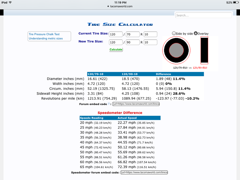

My Zip 100 4t has Malossi Variator kit, pod air filter & (soon) a 125 exhaust (looks original, just bigger)...
I'm thinking of changing the REAR tyre from 120/70-10 to 120/90-10
Specs & differences are in pic.
Does anyone have experience with tyre size changes?

If you've got a friend who has a scooter with the 120/90-10 tire either on front or in back, take the time to see if it will fit before you buy and mount one on your rim. You might not have the room.

On my Vespa GTs, I have been running 140/70/12 rear tires instead of the stock 130/70/12. The reason is to increase the diameter slightly to lower engine speed slightly on my long, fast rides.
The difference is only approximately 2%, but it appears to help a bit in top speed (in perfect conditions) and the reduction in engine speed can't hurt.
The negatives should be a reduction is acceleration but I have not noticed any real difference. This changes much more with changes in roller weights.

2" in diameter is pretty significant!
2% != 2"
So you're saying the tire has a diameter of 100" ? I don't think so.
why dont you read the chart above...specifically the diameter of the tire.

turboblew wrote:
You replied to Bill (it's assumed you're replying to the post above unless you quote a specific post) - and he wasn't talking about the OP's choice, but his own.
