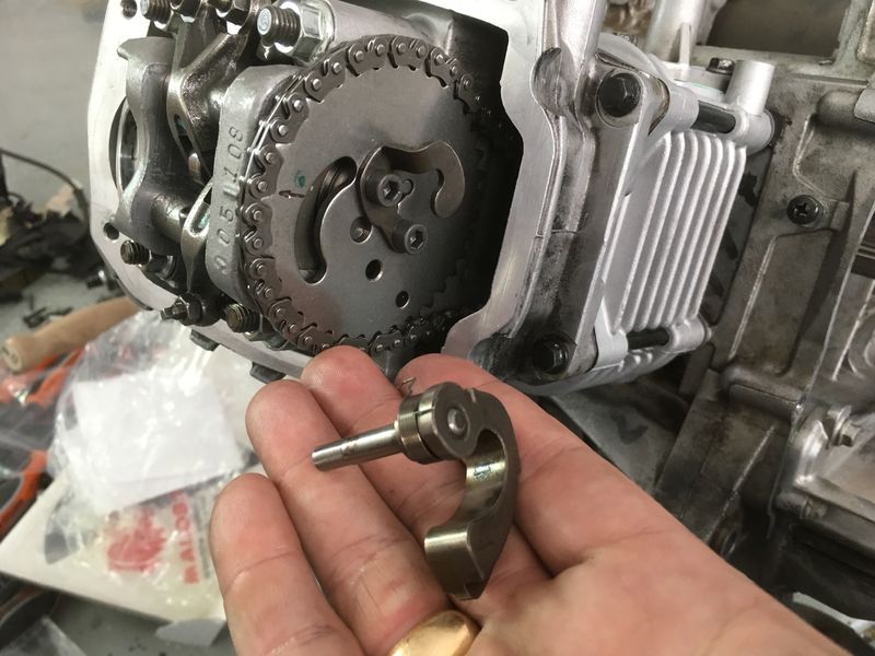

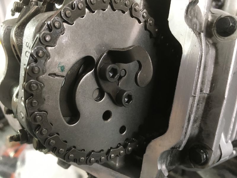

The other thing you'll notice is that the Polini cam doesn't use the easy start exhaust valve cam. I just deleted the extra part and installed the retainer in its place. (pictured)

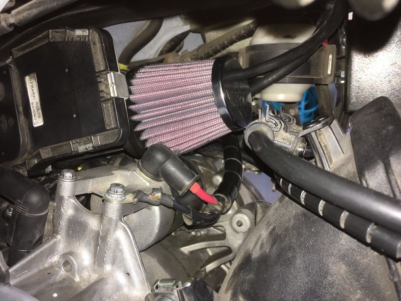

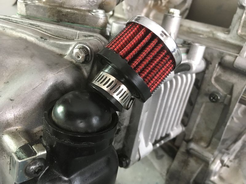

I also wanted a free flowing intake so I used a cone shaped K&N filter. The part number for the air intake filter is K&N RC-2330. It's a 54mm unit. Malossi and Polini sell them also but I went with K&N. This leaves the vent breather from the cylinder head open and in need of a filter. I found the K&N filter part number K&N 62-2480 fit perfectly. It did require a little trimming of the plastic fan shroud that covers the engine but it wasn't much to trim. I didn't take pics of that...
