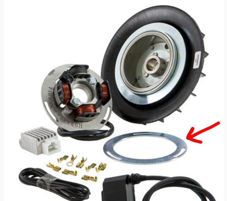

Just ordered the Flytech kit for giggles for my 74 Rally and see it comes with a stator shim. Can anyone remind me what conditions require that? I know it brings the coils closer to the magnets but what scooters require that? This kit is going to replace my stock 6V Femsa system with a Femsa crank.

I've heard comments from people with Vespatronics that when installed sometimes they don't work. So they have tried packing the stator out a little which then aligns the magnets with the coils better. No idea which cases/cranks have this issue.
So the answer to your question might be "When it doesn't work".
