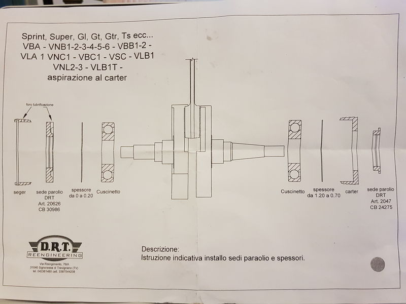

Thanks Shipscat. Mine arrived today and I'm trying to translate the instructions. Am I correct to think that the flywheel side adapter is inserted from the stator side of the case, so that the flange sits on the outside, not the bearing side?
They look pretty well made, but I can see a few challenges ahead. I am using the stator and flywheel from a 2016 PX125.
Posts: 2035
Location: UK (South East)
Posts: 2035
Here's the diagram on the back of the instructions. Looks obvious that the flywheel side adapter inserts on the stator side, but I would have preferred the flange to be locked tight between the bearing and the inside of the crankcase. Hope the adapter can not get dislodged with pressure and movement of the crank.

they are a very tight fit be sure to heat the casing when you fit the and make sure you use a good fitting punch to tap or press them in
as for crank case pressure pushing the fly side out impossible
for the fly side crank bearing impossible the shims take up the thickness of the old style seal
the shims with the kit are the same size as the outer bearing race so no probelms there its just measuring i used dummy bearings
for the stator i used a kind of putty plasticine/blue tac type stuff put it round where the bushing will fit and then fit and removed the stator
i cut a small section out and measured the gap then measured the shoulder on the bushing with a vernier caliper
i think these bushings are quite flimsy and would deform easily with repeated removing and refitting
