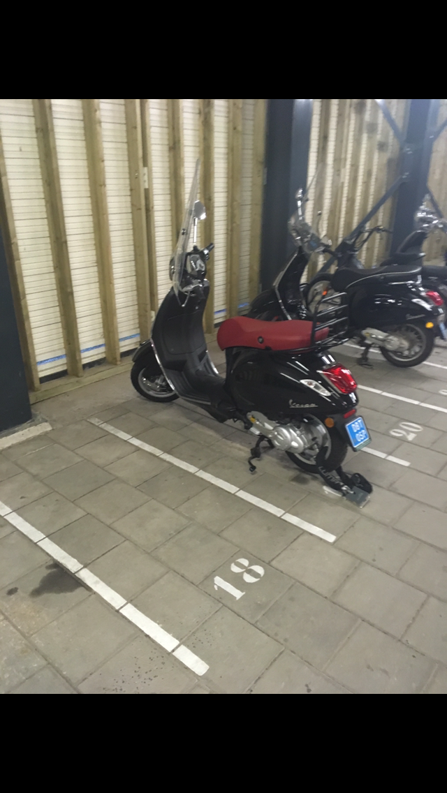

Hi Guys,
My name is Ferry and I'm from Amsterdam. I've been browsing the forum for some time now and thought I would post a question.
I own a Vespa Primavera 50 2V. In Amsterdam if you have a scoot that goes 25kph you get a blue licenseplate and can go on the bikelane without a helmet, which is awesome. Needless to say mine goes 55 and I drive like a maniac.
Which brings me to my question;
What suspension would be best for my setup?
- I drive over pretty mixed roads. Sometimes smooth, sometimes pretty shitty. Mostly I have a lot of speedbumps.The thing bothering me most is when I'm maxxing the Vep over speedbumps it just smashes the suspension. It's the worst when I have a passenger on the back, wich is probably 50% of the time.
- I like speeding through corners and really enjoying the ride,
that's why I'm in need for some good shocks.
- I don't like it to be to stiff. Cause the seat is allready like a brick in comparison to the LX.
- Full adjustabilty would be nice, I like to fiddle with it.
I have searched al over the web and came to the conclusion that for some good shocks it will be around EUR500+. For spending that kind of money I'd like to be sure it works.
I've seen ;
Bitubo,
YSS,
Zelioni,
Ohlins,
Malossi.
Usually Ohlins are great on motorcycles, but what do you guys think? Though I don't know if they have shocks for the Primavera50. I've only seen them for 125/150.
Also, what is the best price/quality deal?
PS: I take good care of my Vespa, I do all my maintanance on my own and treat it very well, even though I ride it like I stole it.
