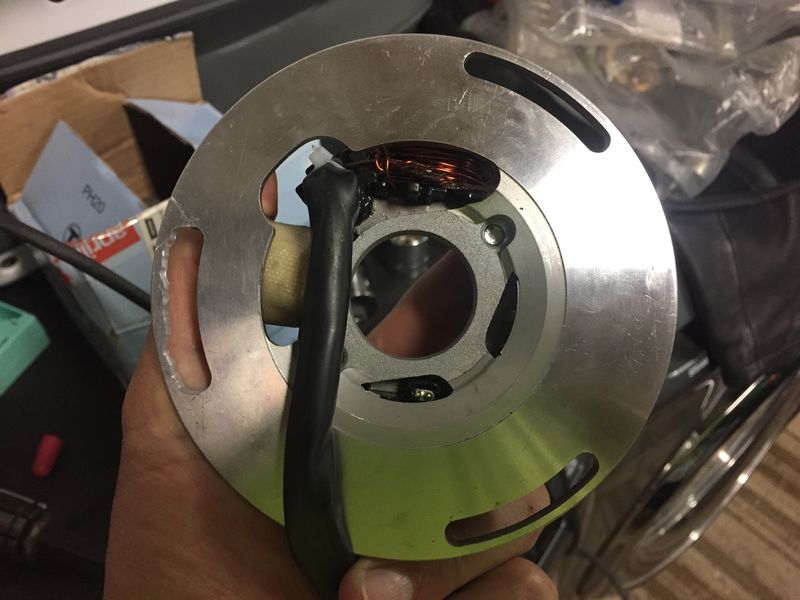

You only had to dremel one screw? You're lucky. I had to dremel all three on mine

Yep. Just one of the three was too thick.

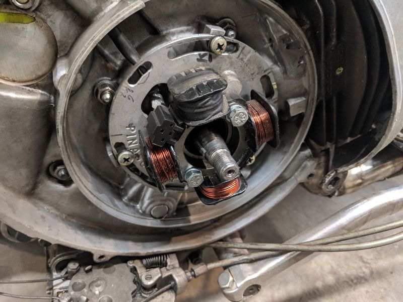

Went to install the kit at a friends where my rally is stored and forgot my extractor tool, spade terminals and 12V bulbs. Crying or Very sad emoticon Installed it anyways minus lights and first look with the timing strobe I'm probably at 23* BTDC. I'll come back tomorrow and set it right.

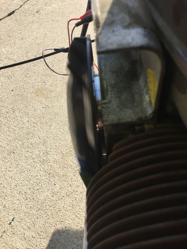

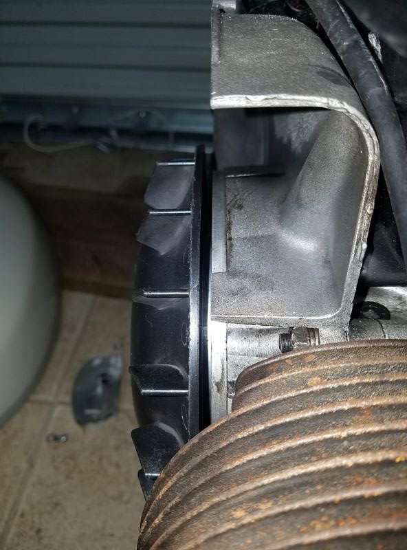

Anyone know if their flywheel has a gap between it and the cases? The flywheel is on and torqued.
I'm definitely not impressed with Pinasco as a company. Their instructions suck, stator plate machining sucks, CDI came with an extra nub that didn't fit the bracket so I had to cut that, there's not enough screws to mount the CDI, no spade terminals to wire the stator to the harness or regulator to harness, no flywheel holding tool or mention that one is needed so I don't wreck the fins. Positive though is it works, less wires and tons of power out at idle. And FYI S.I.P's website shows the wrong photo for this kit.

Do you have a gap? There was no fan cover issues with how it is currently but it just seems odd.

Here's a pic of mine on a p200 motor. I have a 5mm gap between the shelf above the engine bolt and the fan.

I didn't notice a gap when I installed the flywheel, and I've had it off a dozen times. The fan cover fits.

A friend who fitted a Vespatronic to her Rally 200 found it did that as well. She had to space the cover out to get it to fit nicely. So maybe something to do wth the original Rally crank which has not been allowed for?

Reached out to Mark at Scooter Speed and he said the gap is typical. Haven't ridden it anymore. Trucks acting up so I'm taking care of that first.
