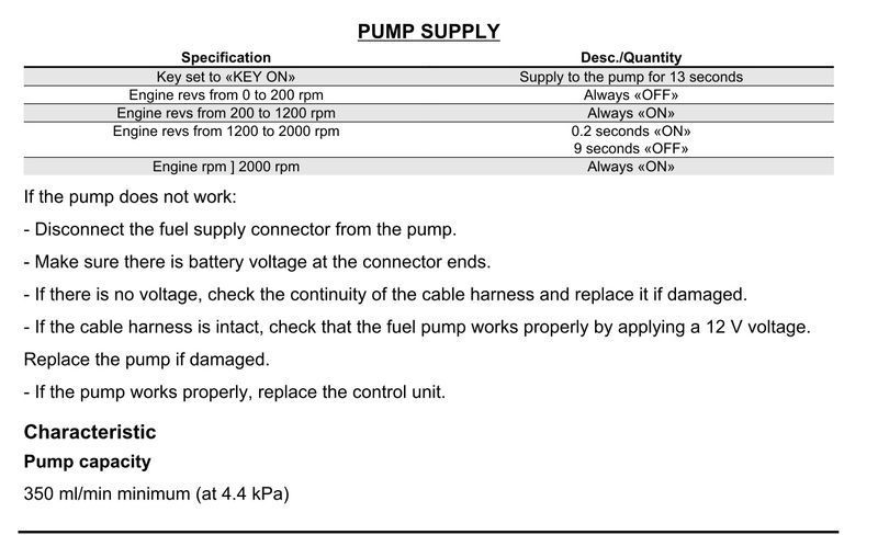

Actually you don't have a fuel tap. Instead your year has an electric fuel pump. So let's start over:
1. Pull the fuel line off the carb.
2. Turn on the ignition and verify fuel is pumped out the fuel hose. You should also hear the pump. This should stop in 10 seconds with the engine off.
You should see fuel gush out of the fuel line. If not, then you need to troubleshoot the pump and upstream electric. PM me if you want a link to my 2008 - 2009 LX150 wiring diagram and the fuel pump test procedure. It's too big to upload here.

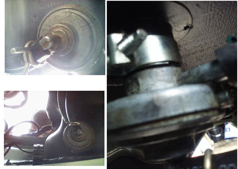

here is what it looks like were the fuel and vacuum lines connect to the gas tank on my LXV 150 [/img] and the engine bay

Ok, so that's not an electric fuel pump. Maybe you don't have a 2009 year?

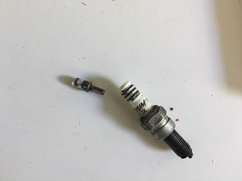

my 2009 LX 150 was sputtering and dying at idle, came across this thread in my search to resolve it. everything here was super helpful but I thought I'd post my fix in case anyone has the same issue in the future.
in my case the spark plug had sheared inside the cap. and eventually broke off when I removed it. I guess it was getting some spark but obviously not enough.
based the earlier posts, I'm thinking of replacing all my lines before they become a problem.
