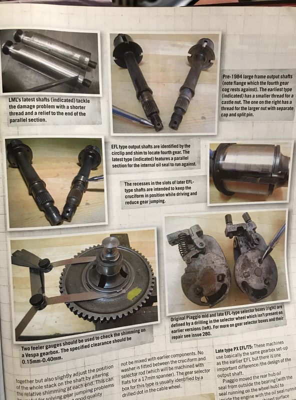

I'm installing all new gears in my 05 Stella and I wanted to confirm a couple things before I start reassembling the motor.
1- There are two snap ring clips and spacers on each side of the gear stack on the axle. Does the thicker (~1.25mm) washer go inboard (against 4th)? The parts catalog shoes the oversize options against 1st gear some I'm inclined to think the thicker is constant and goes inboard and the outer (against 1st) is the one that can be changed to obtain the correct stack tolerance.

1. 1mm washer against 4th gear cog. Thicker, the other side. You should shim the gears. Clearance should be between 0.15mm to 0.40mm (see photo)...
2. There's no washer...
