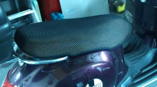

A GT200 seat will fit your scooter as well. It is quite a bit flatter already than your GTS seat. I took down the GT200 seat at the front, and built it up in the crevice. I added a 3/4" gel pad right at the hump. Plenty of room to adjust my position on long rides.

That's what I am looking to do. You did all that yourself? Looks good!

I did do it myself. I restretched the factory vinyl after I reshaped the seat. The mesh cover was $6.00 off Ebay. It's about 3/8" tall and lets plenty of air flow under you. It also keeps your pants off the wet vinyl should you get caught in the rain.
