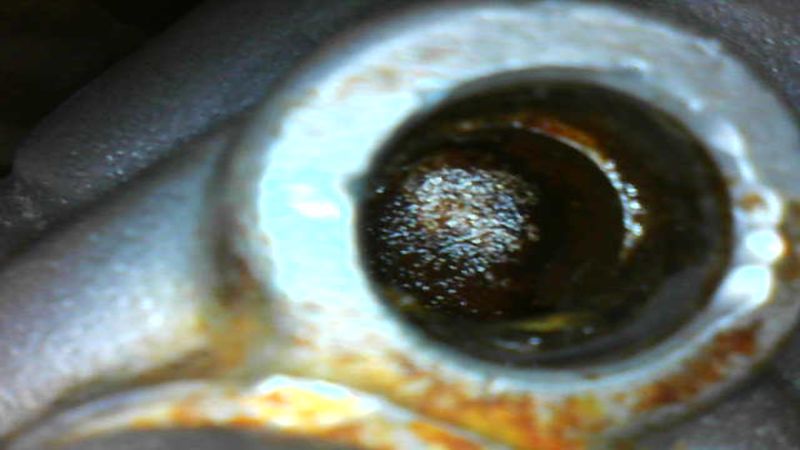

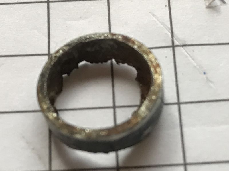

Yesterday I was able to pull out the remnant of the plug. Here are pictures of it and the hole that needs filling. Today I start searching for the plug and sealant for it. Any suggestions would be appreciated. I am going to call some auto parts stores first off. I am worried about being able to get it back in the hole while the engine is in the scooter...but taking the engine out would be the death of me/and or the scooter.
Posts: 18
Posts: 18
wondering now if I turned a piece of brass round rod down to the proper diameter if it would work and be less flimsy when I beat it back into place?? or stainless steel, or aluminum?

Take that piece to an Auto Part store, Not Auto Zone or Advanced Auto, a real Auto Parts store. NAPA should work. They should be able to match one up for you.
If you can get a straight shot getting it in shouldn't be to bad.

I wouldn't use anything other than a proper freeze plug. The freeze plug is designed to flex into place as you hit it. Read up on the fitting technique. Anything solid such as you are suggesting will usually leak due to problems with expansion and contraction differences. The sealant won't last long under those conditions. The freeze plug has to be able to deal with heat, pressure of coolant (13psi), and vibration. Don't deviate from standard. Contact Piaggio hq and ask for the spec of the plug. Although they don't supply it (it seems) they will be able to tell you the size needed.

Got this from another thread. It worked for me. I have about 6000 miles on it since I replaced the plug. No problems.
Mon Jun 05, 2017 5:14 pm quote
Fixed!
The plug that works is made by Melling, part #MPC-108. I purchased it from summit racing. The SAE equivalent of 12 millimeters is .472". The plug measured .478". It was a bit tricky to drive it in straight into the casting, but I got pretty close. It would help to freeze it first if you have the means.

I think I got it fixed this past weekend. Bought a 12 mm plug from NAPA Auto parts for $1 ish, used aviation permatex on hole and plug, and drove it in using a piece of 5/16 round rod welded to a tool I made to fit the plug. Let the permatex set for a day and then flushed out coolant and refilled with Dex cool. Have ridden about 30 miles and no sign of problems. Keeping my fingers crossed.
