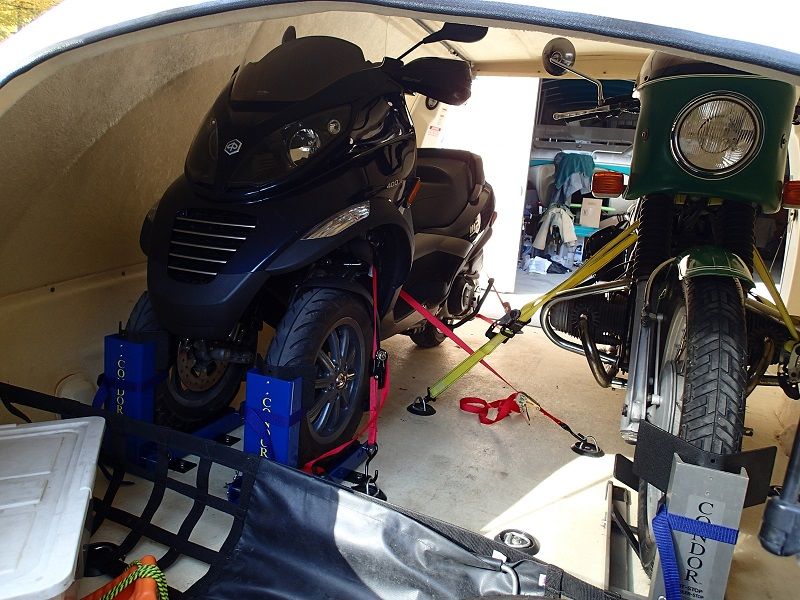

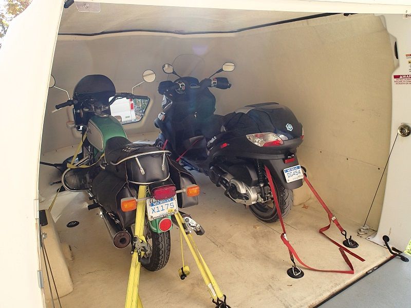

Here are some pictures of my wife's MP3/400 in our RallyTime trailer. Hope that this will give you some more ideas about tie downs. The Condors work great and there are plenty of tie down points for the bikes (The BMW is mine). The best tie down points on the MP3 are on the upper mounts for the shocks. Don't forget to disengage the tilt-lock when you tie down.
We took the bikes from Northern Michigan to western North Carolina with no problems. Some tightening was necessary every day due to strap stretch mostly due to some really rough construction zones on the roads.
