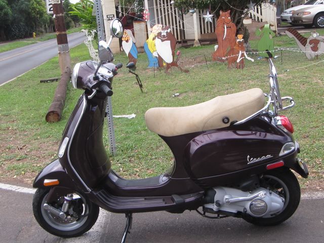

Aloha and welcome to the forum from Hawaii. I have the same LX 150. Twins.Sounds like the dealer isn't that good. Have them reseat the diaphragm on the carb. If it's not seated correctly you won't get above 40mph. Been there done that. I have 48,400 miles on mine. I would also change out the fuel and vacuum lines. Mine last 4yrs tops. As you can see if you keep up with the maintenance they'll last you a long time. I did swap out the carb at 48,000.
Judy, either that picture is old, or you've done one hell of a job keeping that 49,000 mile scoot looking brand new all these years.

JP it gets a lot of TLC. After every ride he gets cleaned and put in the shed. Jack replace the fuel and vacuum lines. Mine last 4yrs max. I'm guessing that's your problem now. Clean the air filter and change out the front tire. While the front tire won't ever wear out it's 11yrs old. I replace mine every 5yrs. You only have 2 tires so having them in good condition is a good thing IMHO.

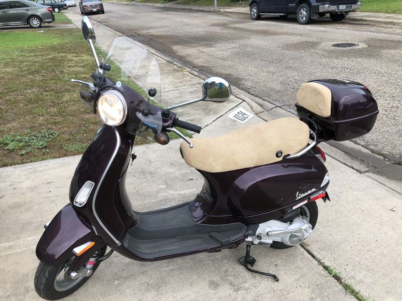

UPDATE UPDATE UPDATE
Vespa dealer replaced the carburetor. What a difference! Got it back two weeks ago. On the first test ride, I managed to (briefly) get it over 70 mph (albeit, on a slight downhill). However, the most fun is the acceleration from ~ 15 to 45 mph. Such a fun ride! And - I have received a lot of compliments. Thanks to all on the board for your help.

Beautiful scoot! Great update - drive safe!
