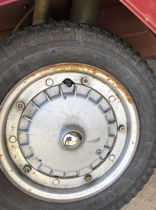

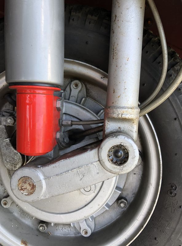

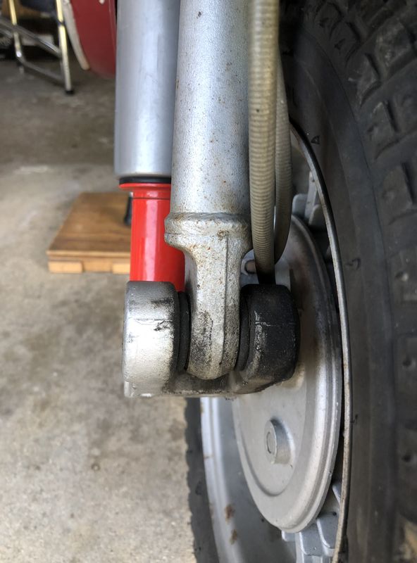

P200 1980 no mods. New shock. I thightend all that could be thightend from the big top nut all the way though the fender, wheel, Linkage. Getting worst and scary. If im driving and giggle the steering it feels rubbery?
Do you think the tube is cracked in the frame? It looks good from what i can see visable. Do you think those rubber bushings on the linkage would cause the wooble?

One good first check. When on the main stand grab the front tyre top and bottom and give it a push and pull to see if if there is excess play and try and diagnose where its coming from.
Could very well just be bad rubber. Different tread patterns react differently.

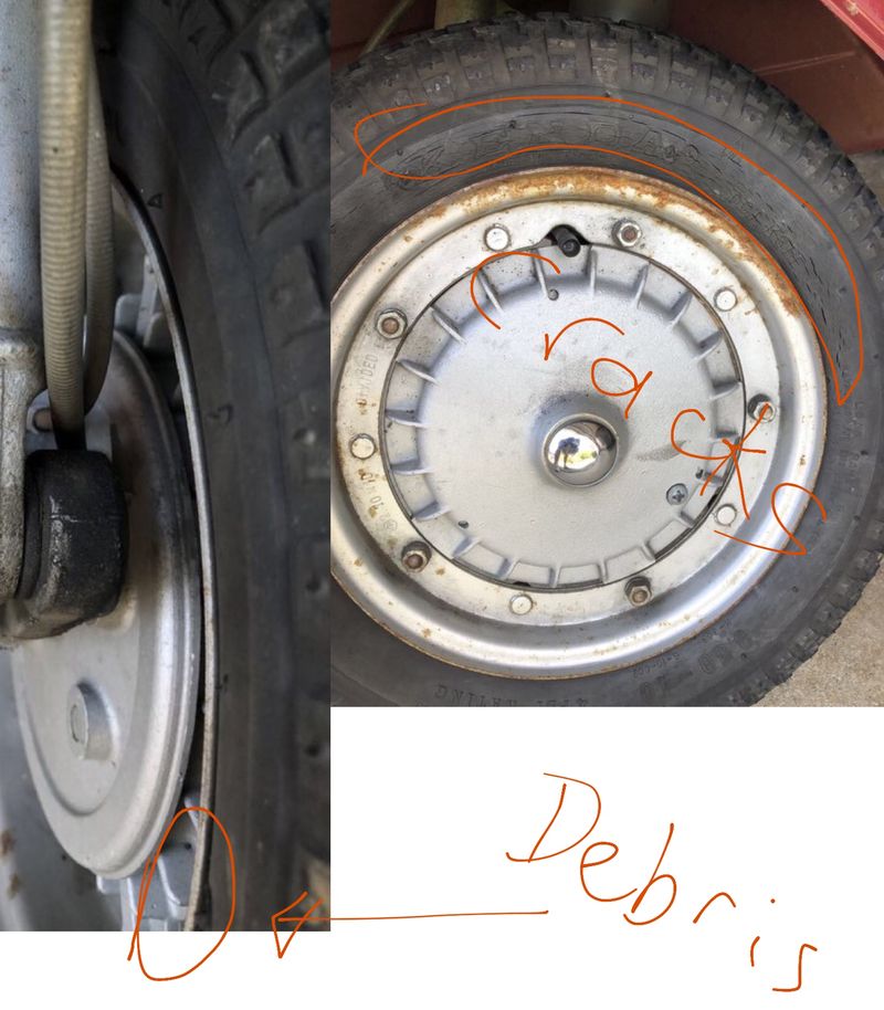

Ditch that rotten sidewall Kenda tire for a start...other than that are there any signs of a front end collision? A bent fork will feel squirrely...

For starters your Tyre is completely & utterly KNACKERED, & 100% UNSAFE!
There should NEVER EVER EVER be CRACKS on the sidewall!
My guess it's been flat for a long time , when you pump it up there is a flat spot causing it to "jump" every turn
PLUS... There is some debris on the bead.

That front tire made me pucker up just looking at it.
Seriously ... get some new tires.

No collision, the fork is true. I'm going to buy some new tires and see if thats my trouble.

This my wobbly shock
So I took everything apart on the front end and everything looks ok, even the rubber bushing on top of the shock. Im thinking its just the shock and the spring it has.
