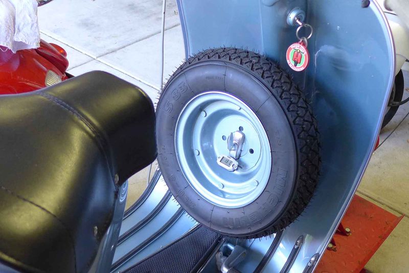

Hi Slashy,
I've really enjoyed your posts, sorry to here about your mishap.
I can't remember where the spare tyre is installed on your bike but here is how I've installed my CHT gauge.
The only hole that needs to be drilled is under the foot mat to feed the wire to the spark plug.
There is an in-line connector behind the wheel so that the tyre can be changed.
The small meter bracket comes off easily if you don't want the gauge in the future.

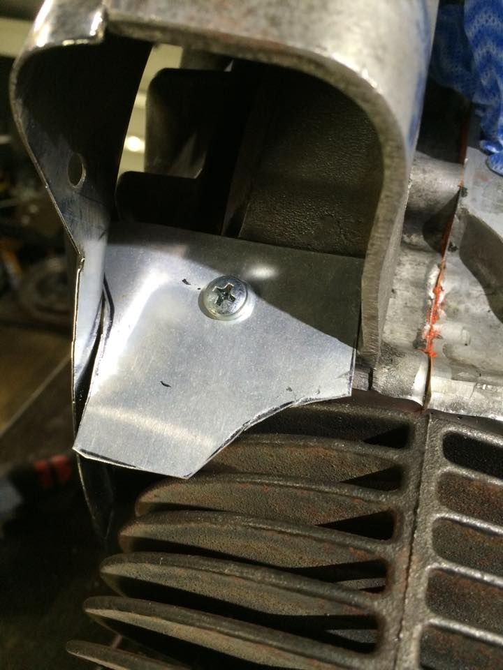

Have you added a little aluminum baffle to the cowl to stop the cooling air short circuiting?
There is a picture on here somewhere.
