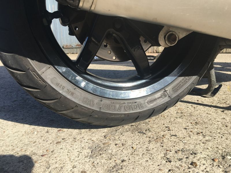

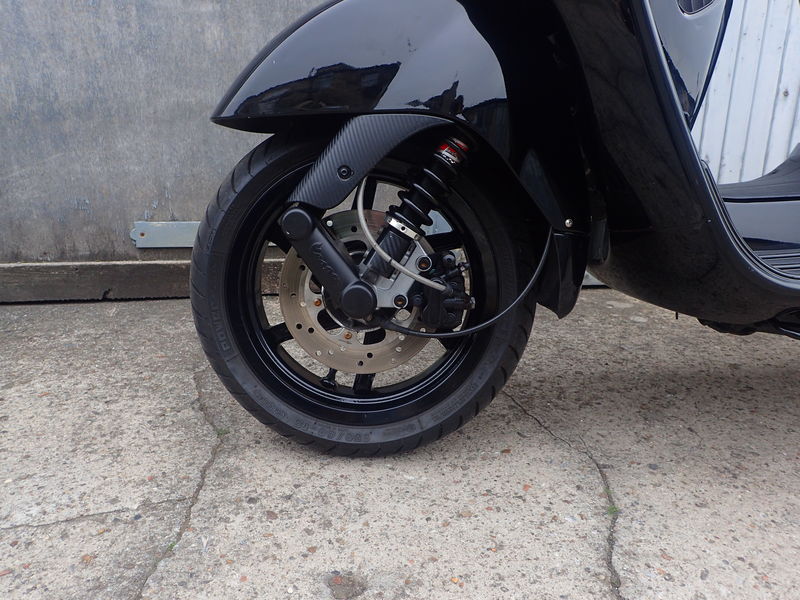

Same rims as I am using
Got a 130 60 13 on the front and a
140 60 13 on the back
Michelin Pure power , they are fine , but I think City Grips next time up[img][/img]

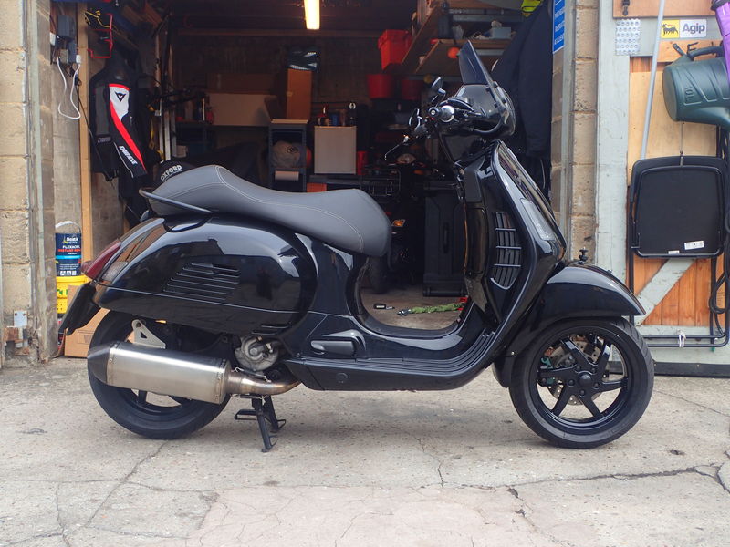

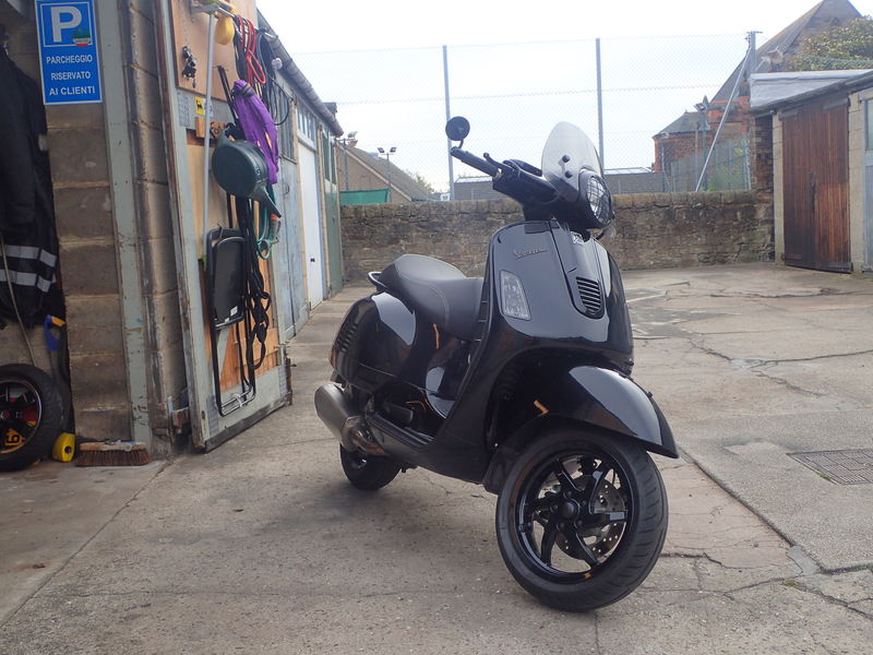

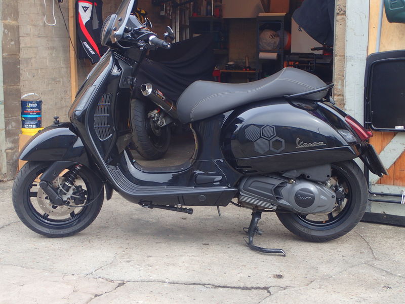

Here you go
Ignore the camera mount on the front mudguard -that's another story.
Garage is a bit untidy too

stage2 wrote:
Here you go
Very nice!!! Why does the airbox seem different from mine? Where did you get your headlight cage?

Only airbox modifications are internal.
Cage was £15 from the bay of fleas

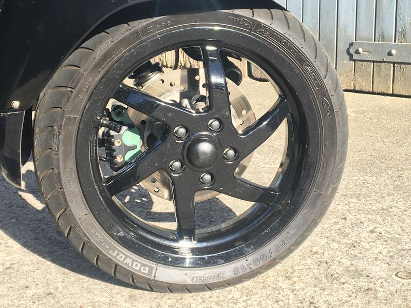

all done, handles heaps better but i've got a not shimmy in the bars low speed, i'm gonna play with tyre pressures to see if that sorts it out and put 13g weights in it too to compensate for the slightly bigger tyre diameter...apart from that, she looks mint!! :D

Looks great.
What pressure you running?
Just checked the front and I'm at 24psi cold

the front was nearly 30psi!! I got it back from the tyre guy and didn't check it...i've dropped it down to 22psi. well see how that goes.

30 psi is high? I run 40 in mine. 22 seems really low?
Woof I hope youre not a heavy braker.
