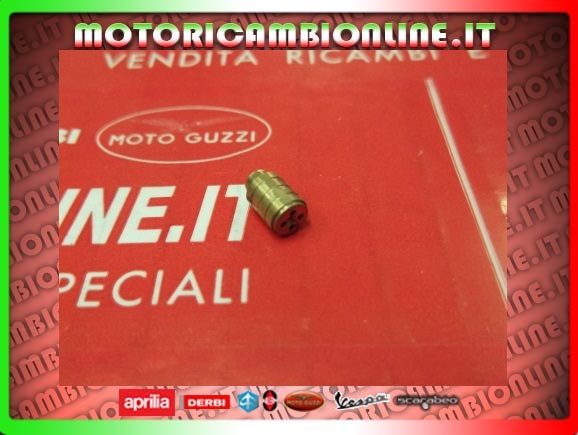

Photos
Photos of the different carbs & other bit may help us
@stipe_zd avatar
Posts: 12
Location: Zadar Croatia
@stipe_zd avatar
Posts: 12
this is carb and everything is original on it...
and it looks identical like this...
As I see it is't good position. Turn half around.

But I am not sure, because I have a 2 stroke. Don't do anything now, until a pro from here check this picture.

I am very curious, aren't this carb reverse? Or something on it?
