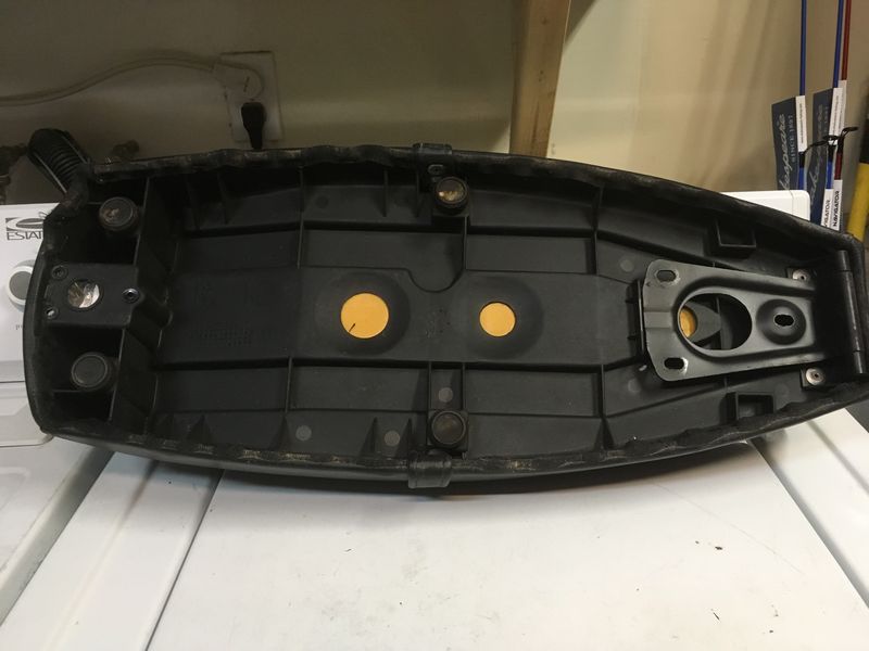

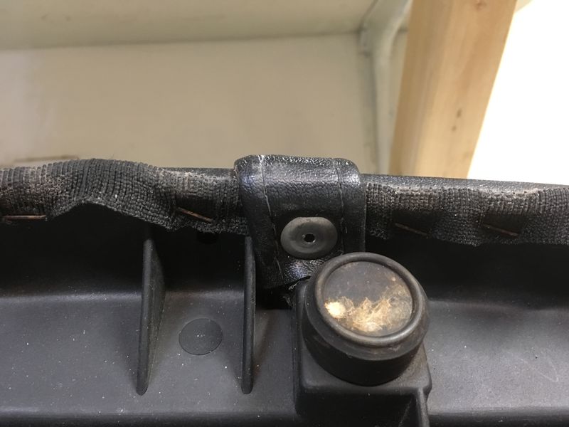

Anyone done it? It looks like it's stapled in instead of the clips on the older seats. How do you deal with the riveted strap? This looks a bit tougher than I'd envisioned.

You got pics? I've only seen and tried on the one with clips.
Posts: 10075
Posts: 10075
Is your seat the style with long springs under the foam or something newer w/foam on a plastic platform. Yours looks possibly aftermarket? I think the older original type uses the clips and the foam on plastic is stapled. If you don't already have a new cover, maybe this would work for you: http://scoot.net/classifieds/forsale.html?id=61718

Voodoo that's exactly the one I got in the mail today. I've not had a stock seat before. The cover is brand new and has the strap too. The pan is plastic. Pics later.

Pic 1

Pic2

That's a later PX Arcobaleno type. Comfier than the old one and with a different cover...

The included cover is a match to the seat, so that's good. Thanks for the ID on the seat.
