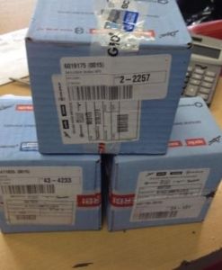

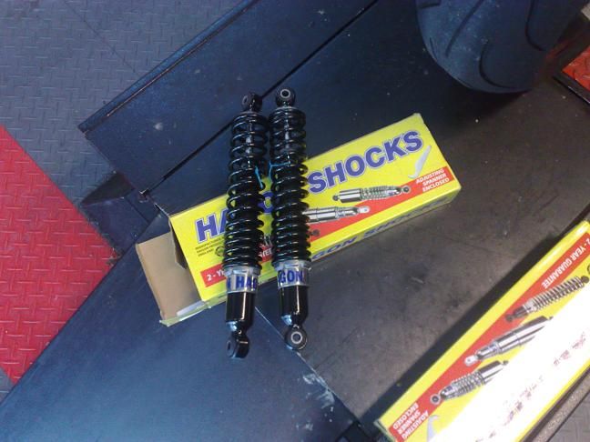

Got NG wave disks instock for the front and hagon rear shocks
the stock shocks are 100.- each
and all the other stuff
Brakepad front are 8.50 a set ( one side) rear 15.75
Set of bearings  all 3  150 euro
Hagon 340s shocks  230.-
NG wave disks are 165.- euro
