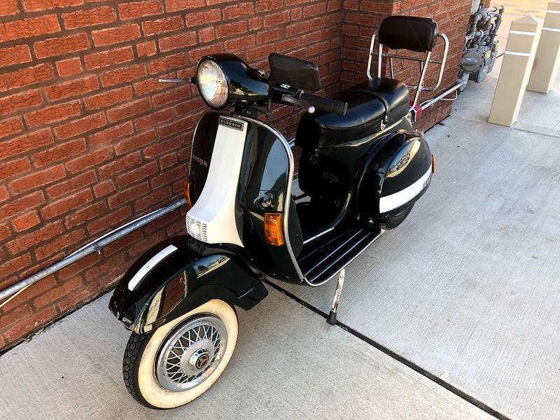

Back again...I am ordering some parts and I want to upgrade my exhaust as well since the old one is lil rusty...
After much consideration I ended up with the Scooter Mercato SR Pipe for my P200e (stock look, still keeping my spare tire and similar gains to SIP Road 2.0 at a lower cost).
Question remains: I have the 24/24 stock carb and I imagine I need to change my main jet size. I have 116 at the moment and I am located in Chicago...so I am thinking 118 or even 120? Please help so I can order all at once...(or point me in the right direction).
I have a big pile of stuff ready to be ordered and I want to save of shipping since I can buy all at once so i can start my updates thread on the build.
Thanks in advance!!!
(pic's of bef and after attached for preview of the direction I am heading [white trim photo is where I started]; for now I did a lot of under the curtains work/investigation: carb adjustment, good clean, paint, oil change, misc bulbs/screws replacement, spedo fix, electrical rework & a list of items that I need to fix-suspension/tires/rims/cdi/exhaust/re work the jets)
