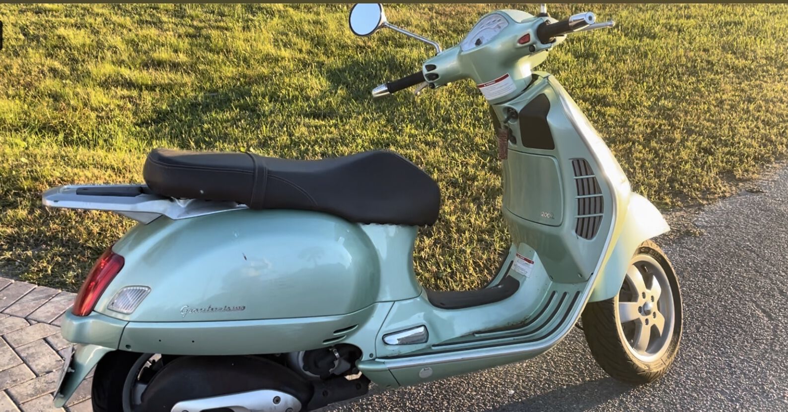

@elazul avatar
2006 GT200L
Posts: 10
Location: Florida
@elazul avatar
2006 GT200L
Posts: 10
Location: Florida
Canada has nothing to do with this slow warm up issue. I have the same issue in sunny warm Florida on a 2006 GT200L. At least 5 minutes before I can ride off. Starts right up too.
Canada has nothing to do with this issue.
Posts: 45969
Posts: 45969
Adjust your valve clearances! Classic symptom on the Leader engine...
@veloce_vulture avatar
1957 NSU Prima III
Posts: 945
Location: House Arrest
1957 NSU Prima III
Posts: 945
Block heater?
Posts: 45969
Posts: 45969
Veloce Vulture wrote:
Block heater?
In Florida? The engine just needs some TLC.
@elazul avatar
2006 GT200L
Posts: 10
Location: Florida
@elazul avatar
2006 GT200L
Posts: 10
Location: Florida
Yes in Florida. Here's a quick update....
I was advised to add some seafoam to the gas. Remember this thing has sat for just over a year. Two fairly long rides yesterday after a long initial warm up time. Put the Vespa away for the night.
This morning, well close to noon.... the time it took for a warm up allowing me to ride off?..... 50 something seconds. BOOM! Issue resolved. Clap emoticon
Thanks for the input.

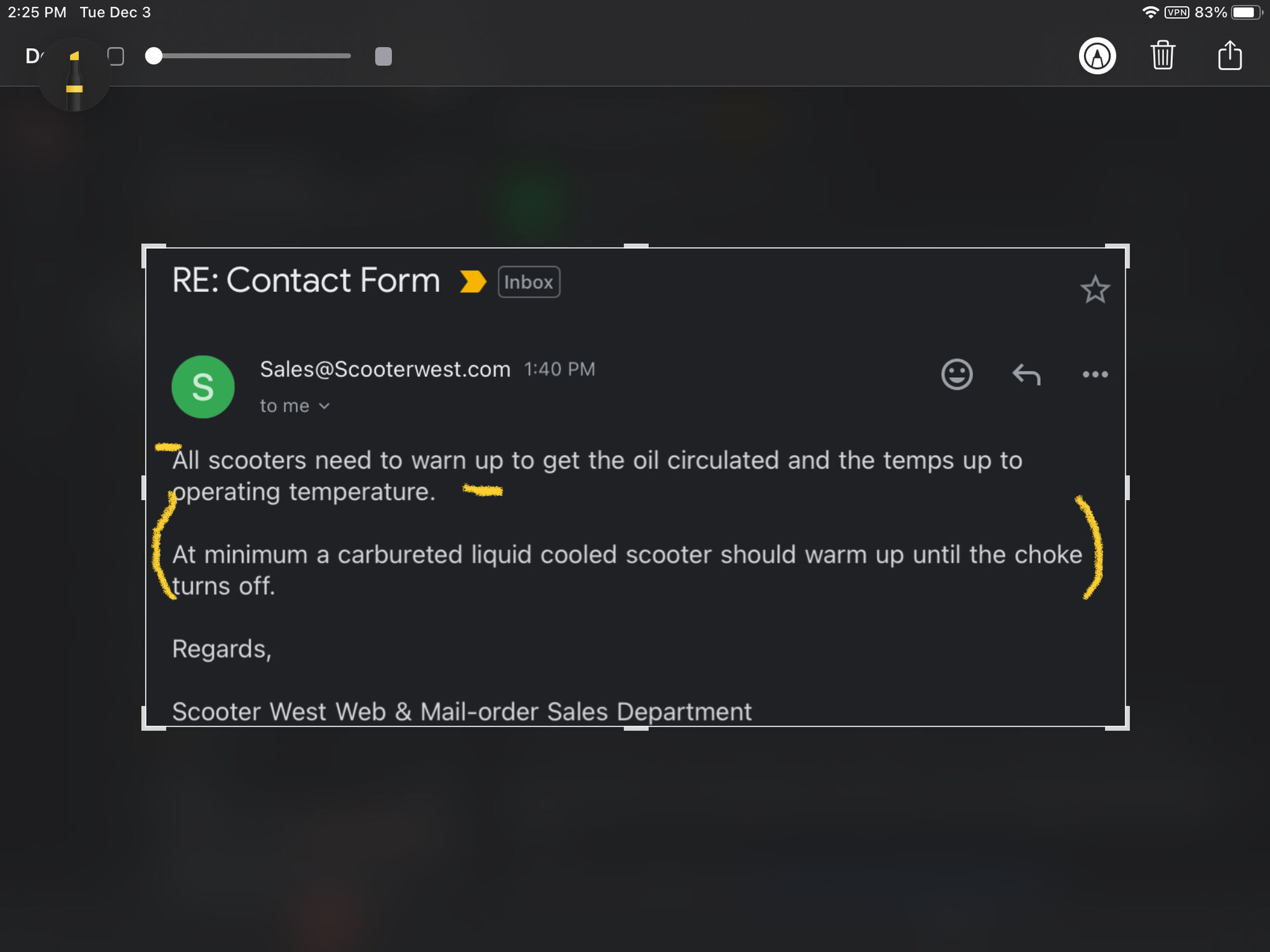

@nitro200 avatar
2005 Vespa GT200
Posts: 173
Location: San clemente ca
@nitro200 avatar
2005 Vespa GT200
Posts: 173
Warm it up first and it will ride better and probably will last a lot longer
Much like having coffee in a morning before starting work
Fire it up let it come off choke then ride
A slow wake up is best.🥱🛵

Posts: 45969
Posts: 45969
Absolutely not! The engine wears the most when it's cool - so "warm it up" by riding it! A GT200 should be able to be started and ridden straight away - if it needs to warm up before it falters or stalls then the valves need adjusting. This has been recommended in the Piaggio tech memos since the Leader engine first came out...
THIS! A warm up by gentle riding warms the engine quicky and safely. Much less time spent idling a cold engine.

Update on extended "warm up" wait time……
Today I cranked up and within 30 seconds I rolled on for a nice ride. So all is good in Vespa Land. Shweeeeeet!
