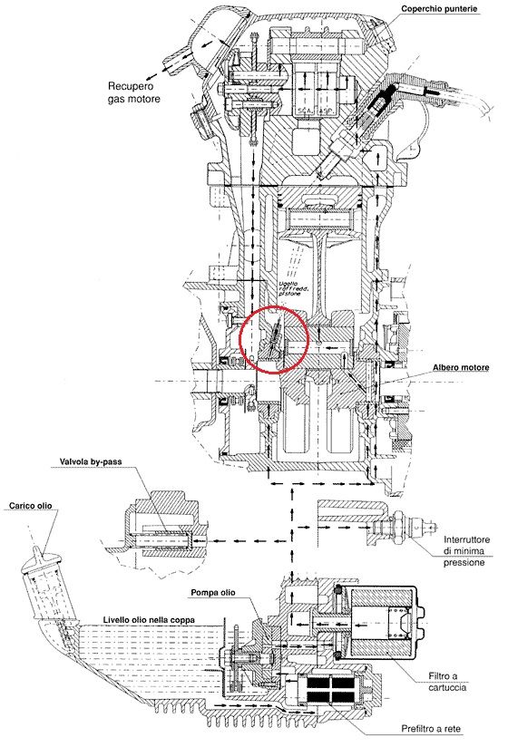

More lubrication huh? Whodda thunk that? If your oil pump is churning around 100 psi through the pump, galleys & filter but simply turning off the throttle, there by lowering the oil pump pressure and back on will increase oil pressure & lubricity??? Laughing emoticon
You are clueless about engine lubrcation aren't you
Cylinders are lubed from oil coming off the crank and some engines, not most have injectors that spray oil onto the cylinder walls to cool them down. Fords Power Stroke Diesel uses oil injectors to cool the pistons.
But these little motors count 100% on oil splash to lube the cylinders.

well when ever you are confronted with a technical question specific to scooters you seem to want to drag irrelevant vehicles or products into the conversation.
I dont care about PSDs. We are not discussing PSDs...matter of fact I wouldnt let one tow my race trailer if given one.
Now back to the question... how does throttling back increase oil pressure and lubricity?
FYI... I do know a little about the technical aspects of building a high performance engine. If I cant figure it out... I have a pretty healthy rolodex of contacts of qualified personnel.

Question from the crowd, if you don't mind.
In a 4-stroke engine, 2 strokes are with high pressure in the cylinder (compression and ignition), one is at ambient or slightly elevated pressure (exhaust), leaving only one stroke (intake) with any possibility of having the cylinder being in vacuum. Correct so far?
Anyway, my question is, wouldn't you get the highest vacuum in the cylinder at highest RPM?
Although correct, actually the QUASAR engine has an oil injector to spray the piston and cylinder. Pictures are taken from the workshop manual...

SaFiS wrote:
Very good illustration SaFIS. Most modern engines now cool the underside of pistons using this method, plus splash. It helps keep the piston rings and lands clean too. But you know all that I'm sure.
