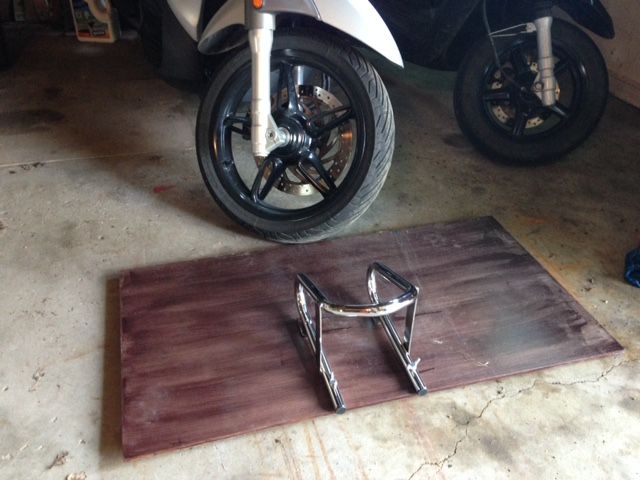

My pickup isn't here to show how this fits, but it's just a piece of plywood cut the width of the truck bed with a cheap steel chock mounted on it. The scooter when it's strapped down holds the chock & plywood in place. I have a similar arrangement that I use with my trailer.

If I were going to use an arrangement like I've shown above with a rental truck where I didn't know the exact width of the bed, I would use a narrower board than the big piece of leftover plywood that I happened to have. A 1x6 board would keep the chock from sliding side to side, and a longer length of it could be cut at the last minute with a hand saw to fit the truck.
