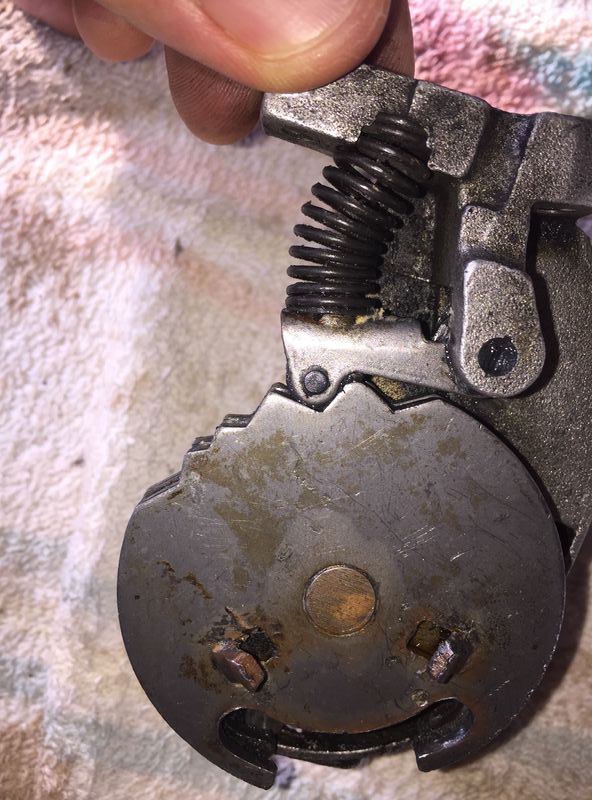

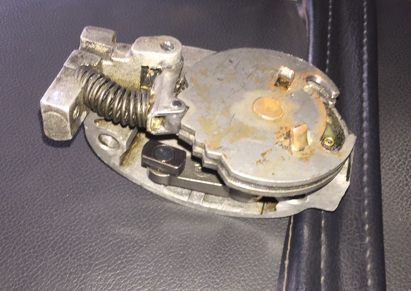

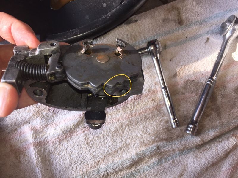

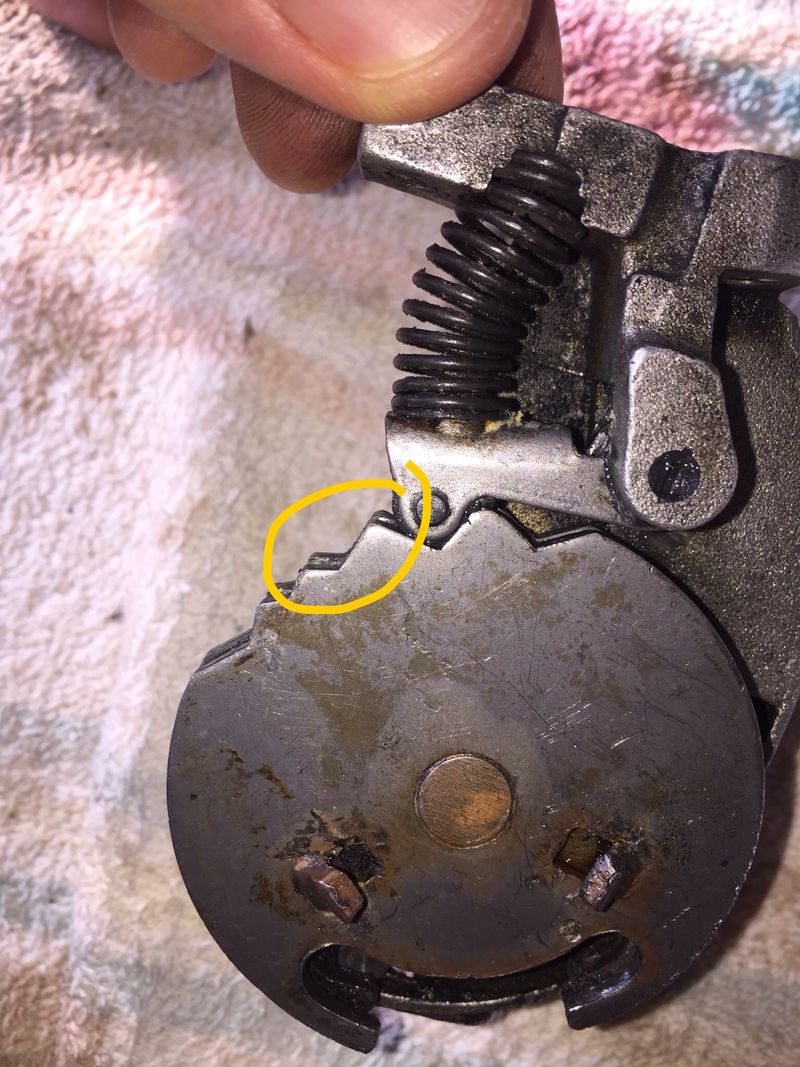

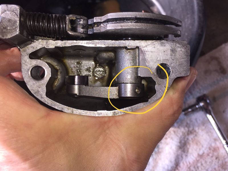

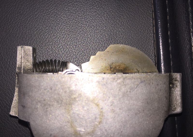

Okay, I pulled the selector box off of the P today. Once freed up from the selector rod, the batwing seems to be in good condition and clicks into all of the gears. The selector arm seems to be in good condition though I did notice one of the pins (one side of the pin??) sticking out a bit.
As for the selector rod, I could push it in and out a bit and it also could be rotated both clockwise and ccw - I tried to tighten it but wasn't sure which direction and I didn't want to inadvertently unscrew it from the cruciform.
I tried engaging the clutch and pushing the selector rod into gear but no luck - it wouldn't budge (but I'm not sure if it is supposed this way).

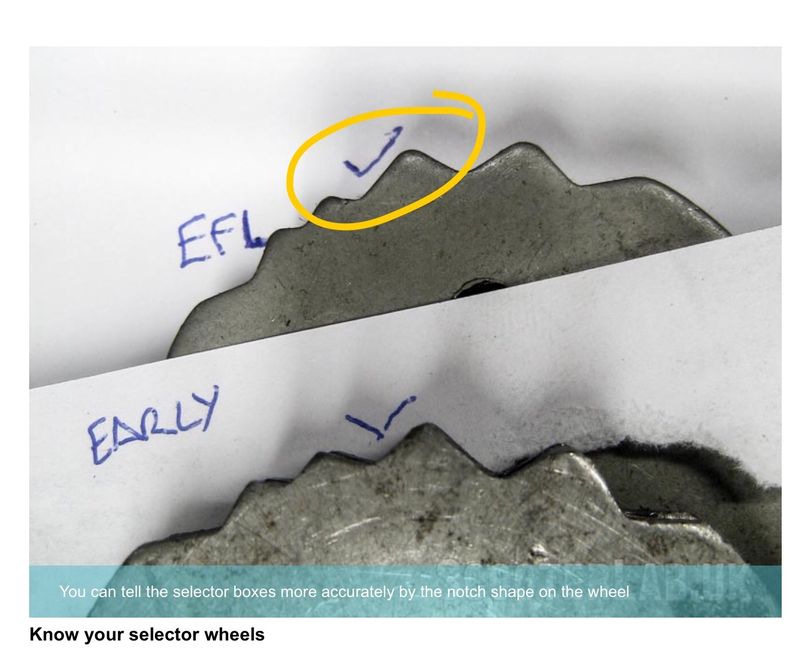

Also, looking at the Batwing gear notches can someone confirm that this is an EFL selector? The 2nd gear notch looks like what I saw on:
https://www.scooterlab.uk/vespa-px-gear-selector-boxes-part-1-workshop/
Pictures to follow.
Thoughts?
@broken_hipster avatar
1981 P200e, S-Works Stumpjumper
Posts: 263
Posts: 263

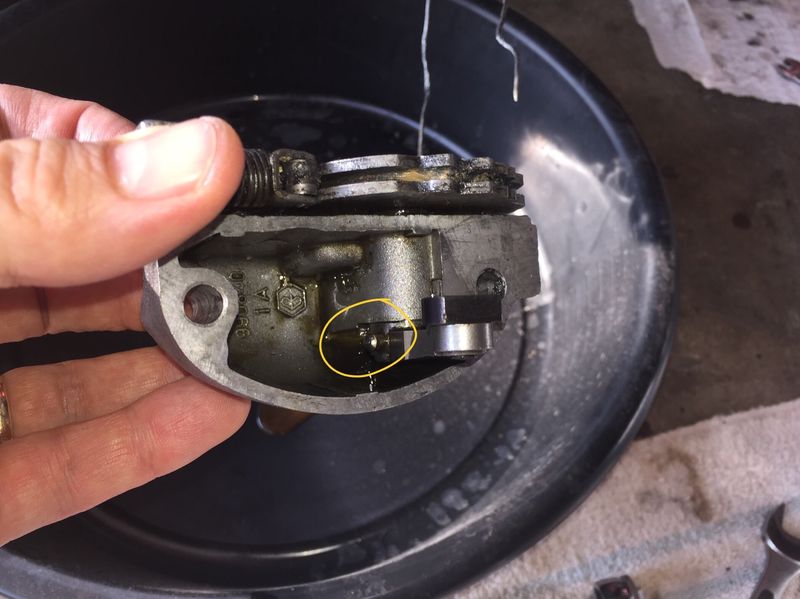

Pin sticking out
Posts: 263
Posts: 263
Other side is this the same pin or a second pin? This side is fairly flush.

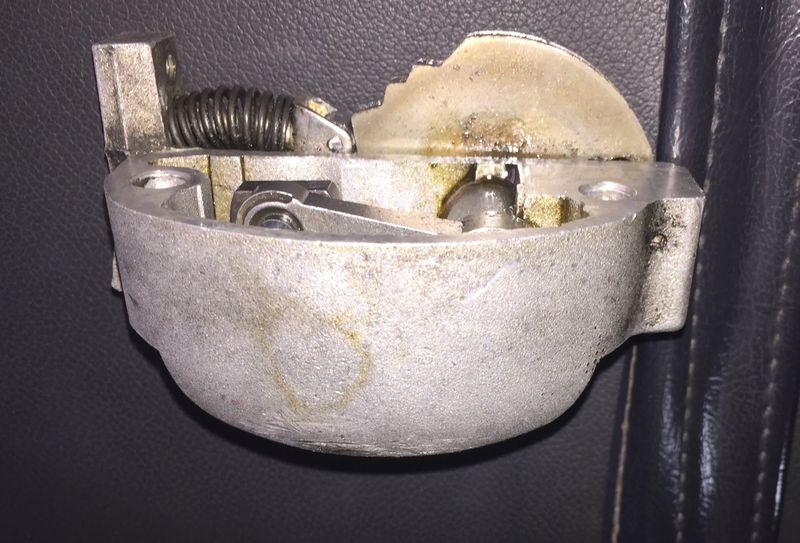

EFL notch on second gear?
Posts: 263
Posts: 263
Another pic

If the rod turns both ways, it probably got unscrewed. Turn it CCW to screw it (reverse thread). To check if the selector box is an EFL one, check the position of the 3rd gear according to your link. The pin is fine. It's supposed to be a bit longer. Also check for play between the batwing's axle and the selector's housing...

Since the EFL P/PX series are somewhat of a rarity in the States, it would be a very slim chance that it's an EFL. Also, if you have a neutral switch on the back of the selector box, look no further because that will mean it's a non-EFL.
GOOD CALL ON NOT FORCING THINGS
Pretty sure the cruciform screw is LHT (well, 1 around there is!)
It's amazing what cleaning does. I use "Start-ya-Bastard" (25% Ether & other petroleum based stuff to get cars going), it's a great cleaner & evaporates. Also, soaking (coiled up, as easier to handle) cables in 2/- Petrol works, & adds a light lube, you will be amazed at how much crap comes out of them
Your cables are loose, & need to be centred, the cables tightened.
Did you check the gear-changer on handlebars end of the cables?
"Search" function will tell you how to do it.
I guess it hasn't been riddden for a while?
If so, check your clutch, as (oil on?) plates can stick them together (ie get all gummed up), then clutch "jumps" into gear, even if the lever is actually doing something
It’s in 3rd.
clockwise the gears go...
1-N-2-3-4
It’s in 3rd. clockwise the gears go... 1-N-2-3-4
That’s in 2nd.
That’s in 2nd.
Broken Hipster,
The selector rod should not rotate if the rear wheel is held still. It's threaded left- handed, so turn ccw to tighten.
Best,
-Slashy

The best way to check a selector is remove the spring.
The pivot on the spring arm is the worst. Can't believe that's like new at 15,000 miles.

Re: the selector box "wheel", according to https://scooterlab.uk/vespa-px-gear-selector-boxes-part-1-workshop/ an EFL selector box has an asymmetrical 2nd gear notch. Mine seems to have a similar asymmetrical 2nd gear notch. But mine also has the connector for the neutral light. Could this be some sort of Franken-selector-box? Wondering if that has anything to do with the difficulty in engaging the gear?
parallelogramerist
Posts: 5994
parallelogramerist
Posts: 5994

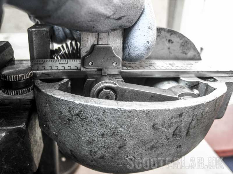

I wouldn't go by the way the notch is shaped...I always go by SIP method of measuring the height of the selector arm (while it's in the 3rd gear notch) from the plane of the selector box box (the gasket face). Since i had a plethora EFL and non-EFL boxes, i was forced to learn just which one was which. Once i had it figured out, i labeled all of my spare boxes with a paint marker.
I had slowly upgraded all of my transmissions with EFL gears over the years, so i had to get a little bit familiarized with both.
http://www.sip-scootershop.com/files/catalogue/index.html#/503

Per the SLUK article referenced, that does look like an EFL selector box, which would be unusual on that bike.
Suppose someone replaced the original selector box with an EFL one? Could that be what his problem is?

Here are some pictures of the selector arm in third gear.
Posts: 263
Posts: 263
Another picture....
Posts: 263
Posts: 263
One more picture...
Posts: 263
Posts: 263
Well, my selector arm seems to be more like the old style (slightly raised above the gasket line when in third) -according to the scooterlab.uk link above.
Here is their pic of the old style selector box arm as it sits slightly raised which seems to be similar to mine.

Broken Hipster,
If it worked fine previously, then it's not the wrong selector box. Just make sure it's in good working order and proceed.
Did you confirm that your selector shaft was loose? If so, that was your problem.

Yes, the selector rod was in fact loose, I had to screw it in about five complete turns CCW before it stopped turning. Unfortunately I don't have any time to put the gearbox back on today, I'll have to wait till next week, but I am really hoping this fixes it.

Before you close it all up, you should use some thread lock or it may come loose again. The factory manual even recommends staking it.

What is "staking it"?
I would need to remove the whole rod to thread lock it correct( never used thread lock)? Since the case isn't actually cracked I'm worried that it wouldn't find its way back into the threads of the cruciform...
