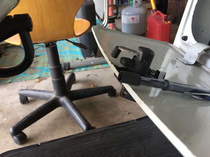

The glovebox on my Scooter rattled quite a bit. I tried bending in the corners, but that didn't help much.
I took another look at it this morning and stumbled on to a solution that worked.
I took the rubber grip off of a pen and cut 2 half inch lengths off. I put them on the latch and lock and the rattle is gone!

Reminds me of the fat rubber band on the smallframe door latch fix. Creative fixes!
