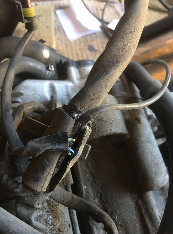

I've got obd2 reader I bought it comes up lamda sensor error I found I broken wire in wiring loom so I soldered it thinking I've crack it took bike for 100 miles run but engine light kept coming on and off but bike back fired a few times and won't tick over . I'm thinking about tracing wires back from lamda sensor again into loom thanks for your help

I've cut all loom back to throttle body and checked wiring with meter I cannot find anything wrong with rest of wiring so now I'm stuck why it comes up lamda sensor. I was thinking maybe it's throttle body at fault

I've cleaned throttle body with carb cleaner re taped up all wiring obd2 coder reader should switch off fault as it says delete fault but still comes back same fault just doing my head in lol took last year with same fault to paiggio dealer all he did was reset code and reprogram Ecu at a cost of 250 pound so wasn't happy thanks for your help
