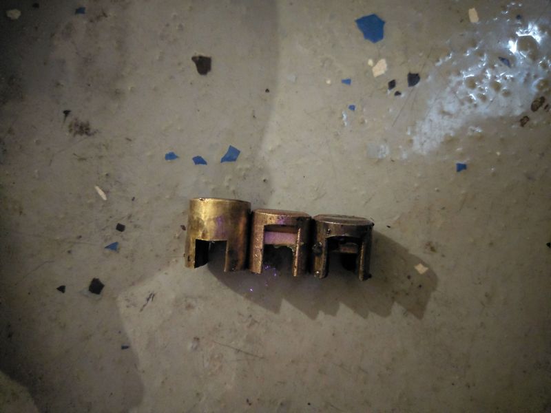

My Super 71 US market model has a hard time to switch gear after I replaced the clutch cable. So I took out the clutch cover to check and notice a weird brass plunger. I have never seen a thick one like this. Is this homemade? Or someone put the Lanny one in?
It's mind boggling. Nerd emoticon
The one on the right side is the one I ordered from Mercado. Middle is NOS.

the left one is what a bajaj super 150 use
