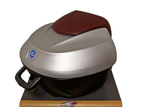

I had this Piaggio 36 l. topcase on my BV350. It removed with a turn of a key and could be carried like a suitcase. Came with it's own mounting plate. I liked it very much for touring (I believe it is still available thru AF1)
