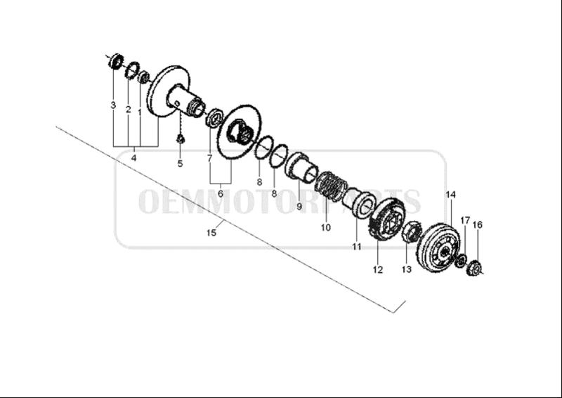

Not so much info on servicing the clutch. Is that something I need to do at 7500 miles? If so, how do I use the O-rings included in the kit?

Number 8 in the drawing, clutch nut has to come off to swap them out. That said my clutch has been apart several times and factory o-rings are fine. Only thing I do when I'm in there for belt/roller R&R is break the glaze on shoes and bell and fresh grease in the needle bearing.

Just do the belt and rollers.
