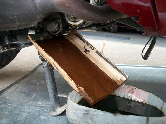

With a couple of harbor freight spring clamps and a double or tripled piece of tin foil works well. I mold the foil into a "U" shape and hold it in place with the clamps and then pull the plug. With a bit of practice you can figure out the clamp points and how to aim the foil into the pan. No mess Razz emoticon

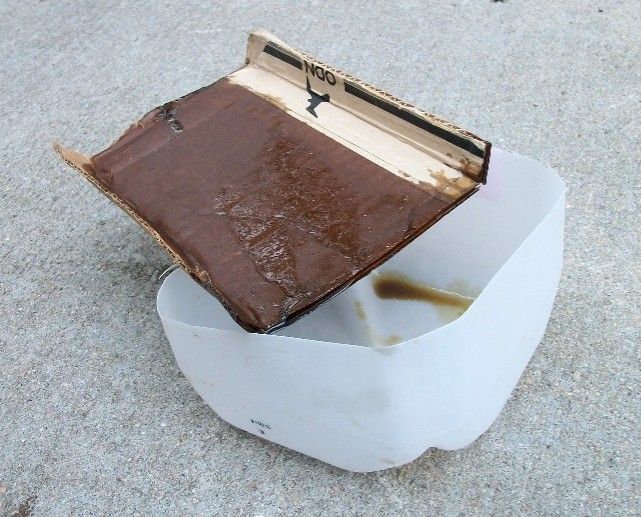

+one on the U shape ramp. I do mine out of cardboard. 8" long seems to work well. I use the same one for the gear oil.
