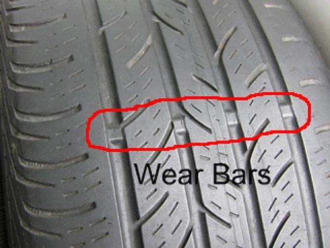

Easier to see on car tyres but the same concept

Good info to have! I've never heard of wear bars before today.

Just remember, motorcycle tires can wear differently than car tires. They don't always wear evenly depending on how you ride and more important (as Jim noted), wear heavier on the rear tire than on the front. One thing I do which is not sensible or cost effective is change out both tires at the same time. I feel like it's safer and it allows me to keep a close eye on the mileage rather than the wear bars.

News to me as well. Good info to have. Appears I've got a long way to go!

In case you have trouble finding the wear bars... I often find the wear bars really hard to find looking for them directly. Instead, there is usually (always?) a "TWI" (tire wear indicator) marking on the sidewall to tell you where they are. Much easier to find that way!
