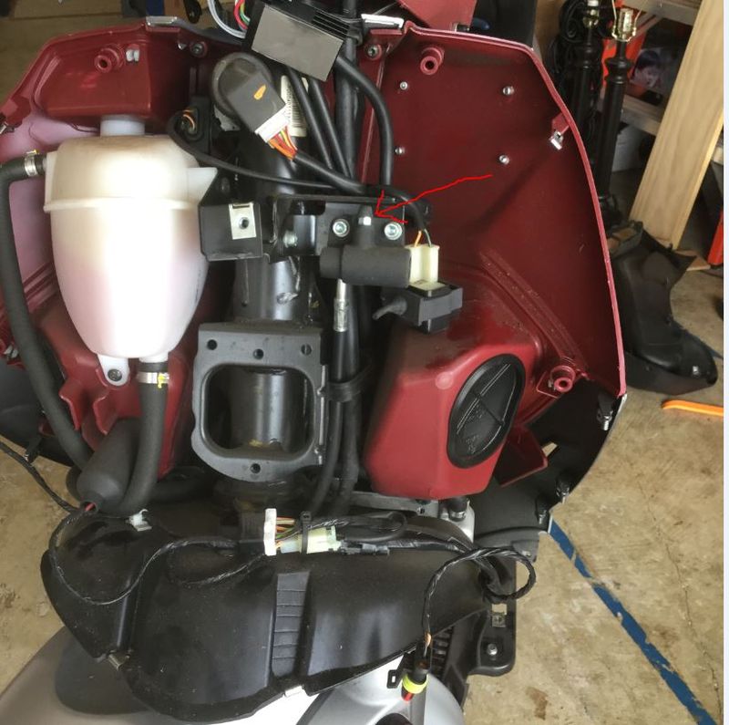

Hi Everyone. I'm finally getting around to changing the brake fluid (manual says every 2 years). The front (right lever) brake system is pretty straight forward. The combined (left lever) is not so clear. Though there is a separate bleed on the front caliper and a bleed on the rear caliper, there is also a bleed in the pneumatic splitter (don't know correct name) (see picture).
The manual says nothing about bleeding through the splitter, but I saw a Scooter West Vespa video that mentioned it needed to be done.
Has anyone else done the brake fluid replacement? Did you bother bleeding the splitter separately? Maybe the bleed on the splitter is just to fill an empty system. It would make sense to me that as long as I'm exchanging the fluid and not letting any air into the system, I should be OK just bleeding the front and rear calipers.
Thanks in advance.

Well, just to follow up. When flushing the left brake system serving both the rear and front caliper, I flushed rear caliper, then front caliper, then the splitter (shown in my previous post). The splitter showed new fluid (it was clear) almost from the start, so I'm not sure if I would spend the time removing the front shield to get to it next time.
I took advantage of having the front shield removed to add a new horn
One other item to note. There are many videos that show flushing using a vacuum (syringe or vacuum pump) on the bleed valve. This works for the rear caliper and the front break (right lever) system, but will not work for the combined (left lever) front or the splitter bleed. Pressure is needed. The old pump break / bleed / repeat worked for these.

Hi Beeg61, as you correctly worked out, no need to touch the brake splitter pressure regulator bleed nipple. It's only really there for initial fill up bleeding to get the air out. Straight forward fluid exchange can be achieved by usual bleed method as laid down in the manual.
