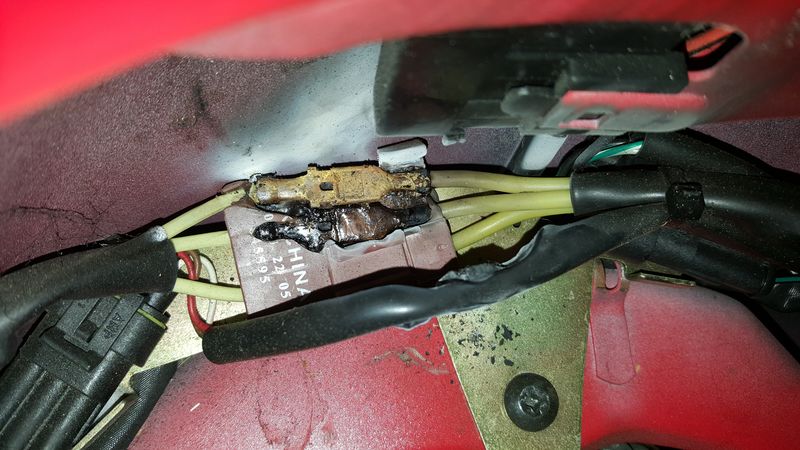

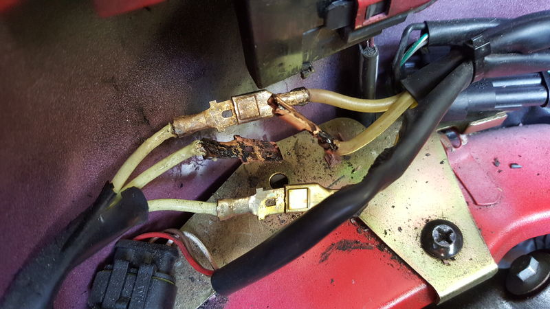

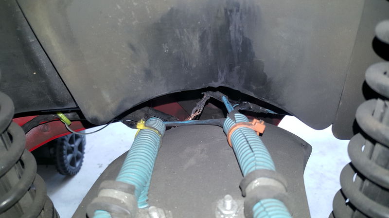

Took the missus for a short ride on a hot day, forgetting to adjust the preload on the shocks. I sensed that we were rubbing somewhere shortly into the ride. When we got home I noticed that the green light on the dash was out, along with all 4 indicator lights. The front turn indicators worked when activated but the rears were totally dead. Found a burned 7.5 amp fuse in position 1 of the fuse block. Replaced it, which restored the front lights along with the green instrument cluster light. As per the photos below I think I have a bigger electrical issue that needs attention. I think the frayed wires above the rear tire were due to the tire rubbing against the flimsy plastic fender. At any rate I'm pretty sure the rear lights can be fixed by patching those wires. My primary concern is the fried connector in the front of the pet carrier.
Any input would be appreciated. My electrical skills are minimal. Not sure if this is a voltage regulator problem or simply a short caused by overloading the scoot on a hot day while bottoming out the rear shocks.
UPDATE: The frayed wire was a relatively easy fix. Just re-insulated and ran longer lengths of the blue wire tubing in picture 2. All lights are working again. Just need to figure out that melted connector. Just under 12V before starting, 13V at idle, 14V while riding.

That is not the first picture of that connector being melted. I think it happens with some regularity, which I believe is because it is a cheaply made part. Possible solutions - buy another quick connect and re-wire it; snip the wires and put connectors on each wire instead of using a quick connector (be sure to insulate it well).
I replaced my voltage regulator a few years ago. While messing with that I found that there is very little clearance between the pet carrier and the metal of the body. In other words, don't buy a big clunky quick connect and expect it to fit in there. If my connector ever fails, I would snip the wires, solder spade connectors on pigtails to add 2-3 inches and plug each wire together separately and do away with the modular connector.
If your VR fails, it usually overcharges at 15-18 volts. It will burn out your headlight (and maybe others), boil your battery dry and maybe do other damage. If it has failed the orange check engine light will light up at any engine speed above idle, i.e., it will not glow at idle but will when revved. The VR is hidden away in front of the radiators in the leg shield and takes a lot of doing to get to it. I think there is a pictorial on here somewhere - use Search function.
Hope this helps. Let us know how it works out.
PS - check your ignition coil to spark plug wire at both ends to ensure its still firmly connected. Flexing the wire (hitting bumps while two up) can somewhat pull it out of one end or the other, and will blow a 10 amp fuse on the left side of the pet carrier.

The connector between the stator and the regulator is a common failure point. High currents flow - and if there's the slightest bit of corrosion or dirt on the contacts, there'll be some resistance. It doesn't take much for it to get very hot indeed.
Easily remedied - just cut out the connector and any hard wiring/insulation, then splice or solder the wires together, adding some extra if needed. It doesn't matter which one goes to which.

You're at least the fourth person to have this specific failure, including me. The blade terminal is not fully inserted into the receiver, causing all current to flow through a diminished surface area, due to incomplete insertion.
Look carefully at the spade and receiver they are not mated fully.
Mine failed at the Vespa dealer in Santa Rosa, CA in front of the technician.
I repaired mine with positive screw terminal connectors.
The pet carrier will not go back into the its "home" if you use terminals that are too high. Find some that are small enough to fit in the narrow gap between carrier and steel cross member.
Hopefully, this failure didn't take your voltage regulator out. Mine survived FWIW.

No need to replace - just bypass!
As the wires are the same colours mark them before you start 1-1, 2-2, 3-3
No need again - it doesn't matter which one goes to which. It's just a three-phase alternator.

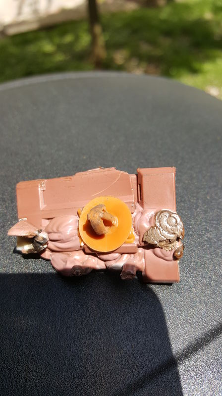

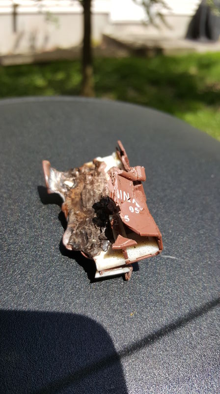

Had to break away the cheap plastic housing around the 3 connectors. 1 out of 3 looks almost brand new but the middle one is the one that I think was causing the biggest problem and the third one seems like it can be cleaned up. Is there any reason I couldn't just sand these contacts back, put some contact cleaner on ithem and re-insulate all three wires without using the plastic housing?
w.

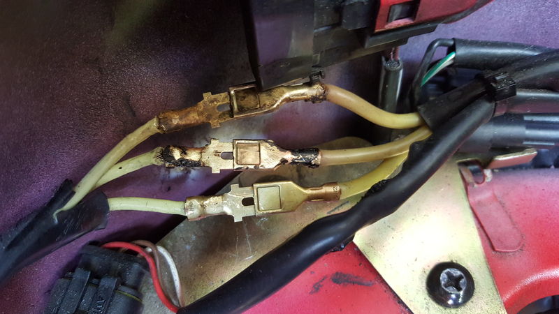

Used a dremel with a wire brush and some contact cleaner. Looks decent. My only issue is that these blade couplers are non-locking. Thought about using some heat shrink to insulate and snug the fittings together (individually of course) then use sections of wire conduit to protect everything.
w.

What if the bad connection was between one of those spades and the wire (and not between mating parts of the spades)?
With damage like that, I'd cut it all out and solder the wires together.
w.
Sounds good. It's worth a try. Run it a while and see if the connections get hot.

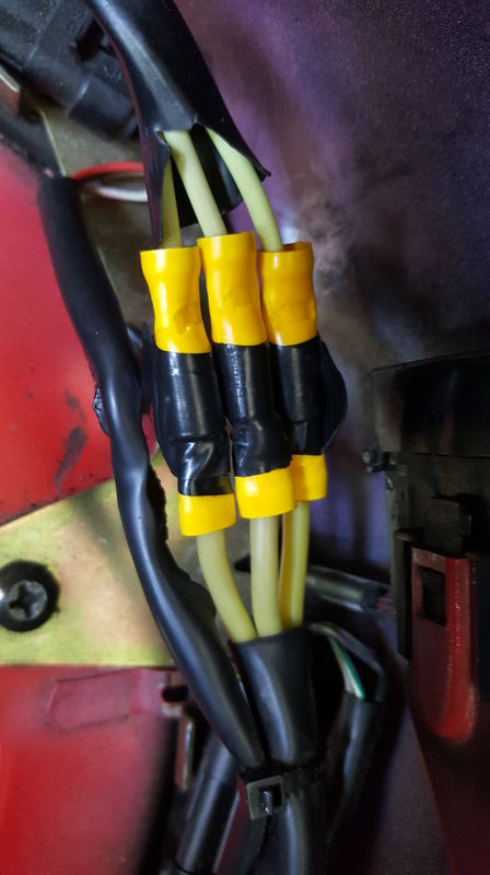

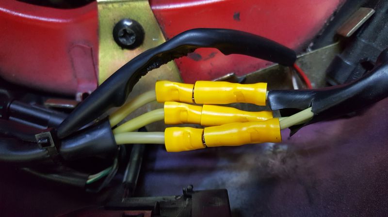

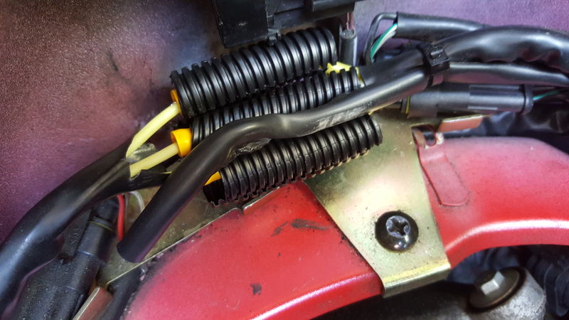

Ended up crimping in a set of snap connectors after snipping off the old stuff. There was enough play in the wiring to avoid soldering in new connectors. Let's all hope that it stays together.
w.

I see you ended up doing mostly what I said above.
Does the pet carrier foul the connectors now?
None of the three spade blades were fully inserted in the original connector. This was a factory assembly defect.

Everything tucks in nicely. Hopefully these snap connectors do the trick. Wiring on my Vespa has been my biggest headache, compounded by the fact that the previous owner messed with it to install a light modulator kit.
