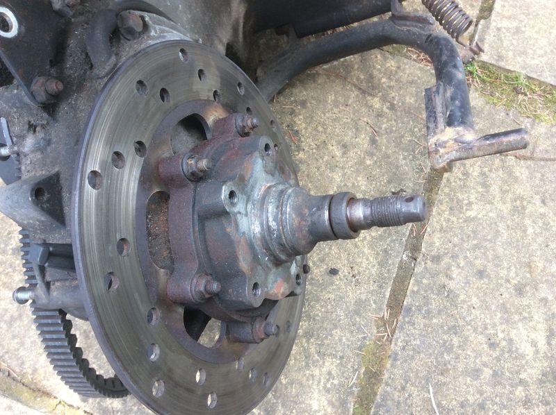

🤔 I'm stuck again I'm afraid. I have noticed on the engine I'm picking up tomorrow has no brake disc on it just the treaded rod that the wheel fits on , how do I get the old disc assembly off the old one ?

I can see how to get the disc it's self off but not the whole unit 🤔

I believe the hub just pulls off. That said on my S50 it took PBblaster, heat and a 3 prong puller. It was touch and go but in the end I won. I had a impact gun on it before I went to a tire iron for leverage. The PBblaster was as important as the 3 prong puller.
Posts: 45711
Posts: 45711
That whole hub complete with disc *should* just pull off. However, seeing as it's been stuck there for humpty-dumpty years, you will need penetrating oil and a good puller.
One of those things that should be checked as free to move every time the rear tyre is off...

Ah ok but I can't even seem to get that spacer off infront of the hub 😫

Thanks for letting us know it worked out. What did you do to pull the hub off?

I got a rear hub and brake disc from the garage I got the engine from 😊
So I was lucky there because I couldn't budge the the other one .
