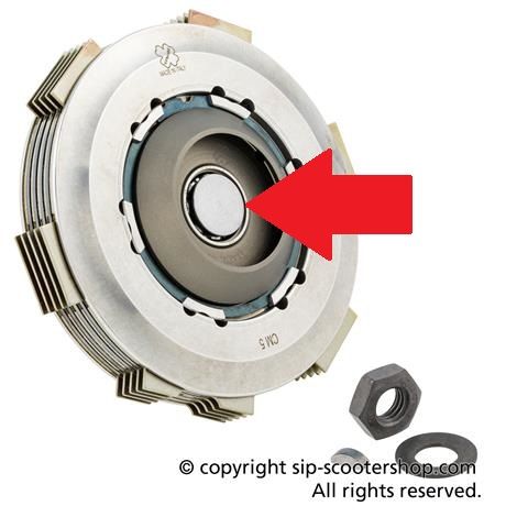

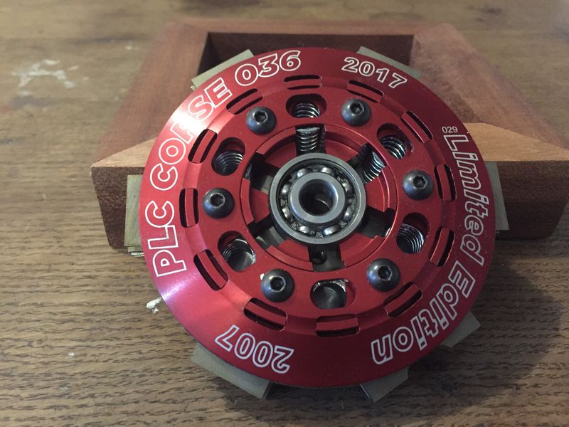

Shouldn't there be a plate in the center of the bearing?? Where is the plunger making contact?? Look how Crimaz has done it...

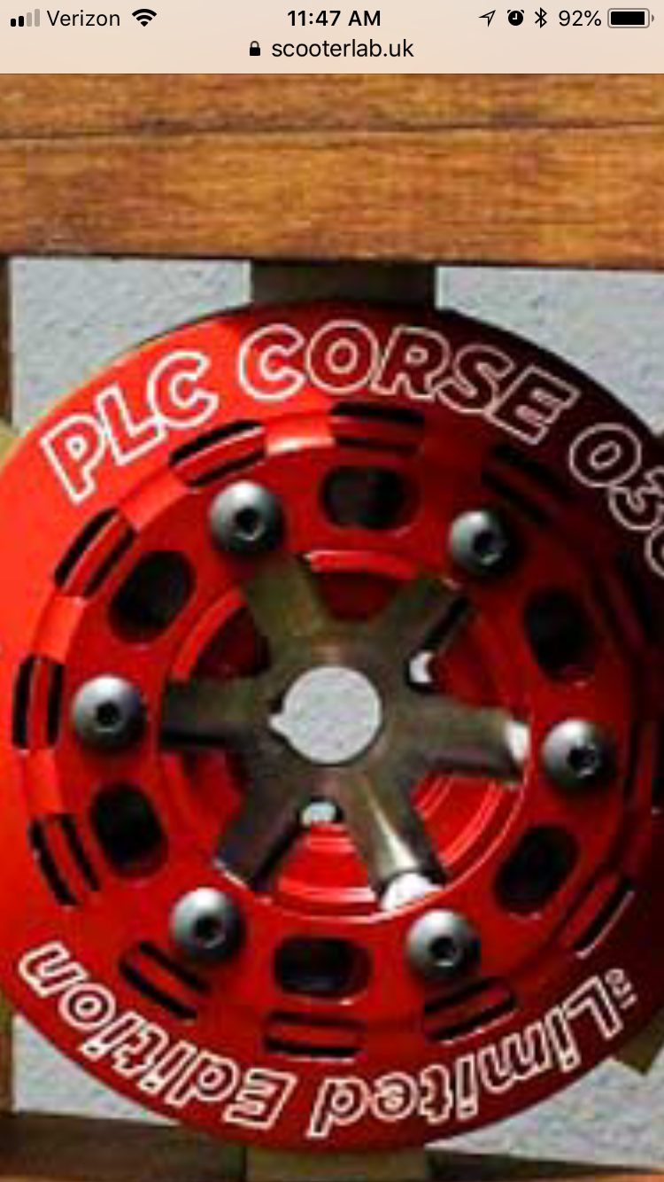

Installation instructions show no pressure plate, there was none in the kit. Haven't heard back from the manufacturer yet.
I did find this photo of the clutch which has something resembling a pressure plate, but I never saw one of those in the shipping box

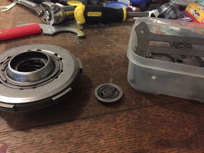

I have the original pressure plate. I never considered using it with the new clutch. But I can tip the scooter over and pull the clutch tomorrow to try it. Not sure how it would lock in place like on the old style clutch.

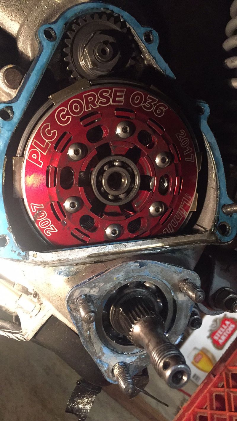

I opened up the clutch today, there was 6 loose hex bolts, I added some blue loctite and reinstalled them, also checked the woodruff key and it was okay. Probably a good thing I checked it, if those hex bolts had come all the way out it would have caused some damage.
I put it back together and the clutch is working pretty well.
I did hear back from Plccorse and there is no pressure plate with this clutch.

Sorry to say this, but for the money you paid for this clutch, having no pressure plate is just a stupid design idea. That bearing is not designed for side load and in your photo, it already doesn't look that good at it's center. I hope it won't blow up at some point in the future...
