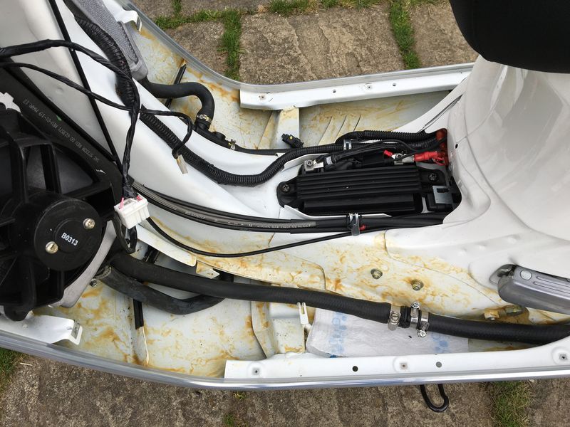

Last weekend when I replaced the coolant !
You must have a leak somewhere ? Common place seems to be the joint under left foot board , Any drips under scooter ?

Fud, this is a very good question you pose! Well done for posting about it. It's one of those out of sight, out of mind issues. I'll second the comment super-fly made too. He and I have both had that underfloor issue. It quite common and an easy fix but annoying. If you have it you will notice the odd drip of water/coolant on the left underside of the bike where the 'shark gills' are. It normally requires a new hose clip to be fitted. You can do that without a drain down so it's straight forward enough to convert to a hose clip type that uses a screw tightening method. This is much better than the one time use clips fitted at the factory as these seem incapable of lasting for very long before they allow the hose to weep. Of course your leak could be somewhere else so do have a general check around the bike to see what's going on.
Fud, you probably know this stuff, but don't forget to use the same stuff for top up as is already in your bike. This is always worth repeating for any folks that may read this and not be sure. It should be Ethylene Glycol OAT based engine coolant, that's what they come from the factory with as far as I know in most countries now. You could check with your dealer to be sure or look in the owners manual. Other coolants often say they mix with anything but often they don't fully mix and can cause some issues later down the line, although it is ok to mix genuine OAT ethylene glycol coolants. Additionally, if someone has used something else in youir bike after doing a complete flush, and you don't know what they've used, it may be prudent to do a flush and refill. But as super-fly says, you definitely have a leak.

I used 2 clips plus cut piece of pipe out so it slid farther on joint , Better to use a single wide band clip , I did think it was leaking again but has stopped now so might have been old coolant in there or it's sealed itself
