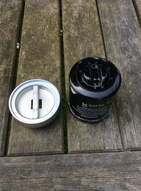

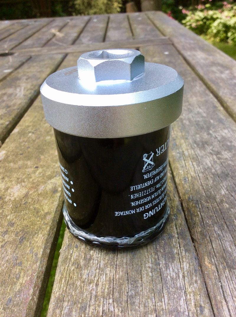

Fits the piaggio/Malossi/Hiflo filters with the groove .
Well made and £13.50 uk pounds .

I wished I'd bought one of these. I changed my oil yesterday, went out and bought a chain type remover. It did the job but I marked the engine casing a bit as it was a tight fit.

7" plumbers strap wrench works well for me.

I just use a screwdriver with a squared shaft to get the filter off.
That, and/or a T-handled screwdriver from back in my bike mechanic days.

Gee I just make my filter hand tight and take it off by hand too.
Bottom out then 1/2 turn more by hand, then a little effort to remove it two hands.
