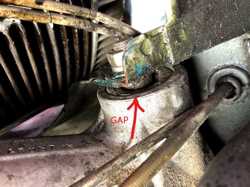

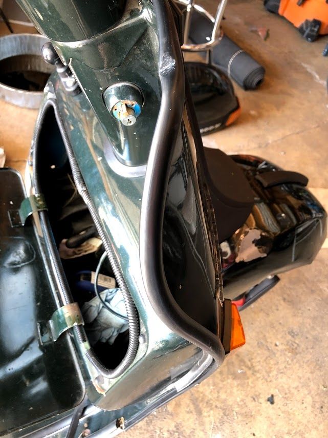

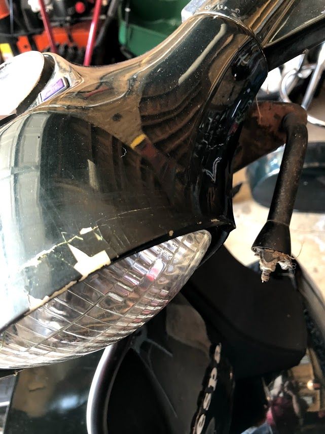

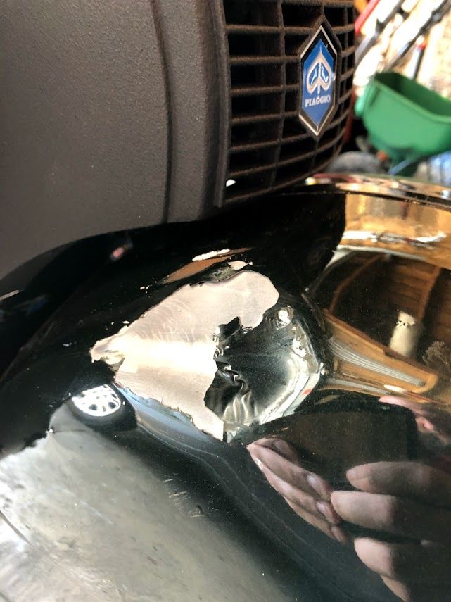

That being said photos of the damage. Biggest question is the frame. After I hit 2 curbs frame seems to be twisted...
1. rear tire has a lean which before it was perfect 90*
2. engine mounting (front bushing area with the bolt) has a gap now as seen in the picture...before it was flush

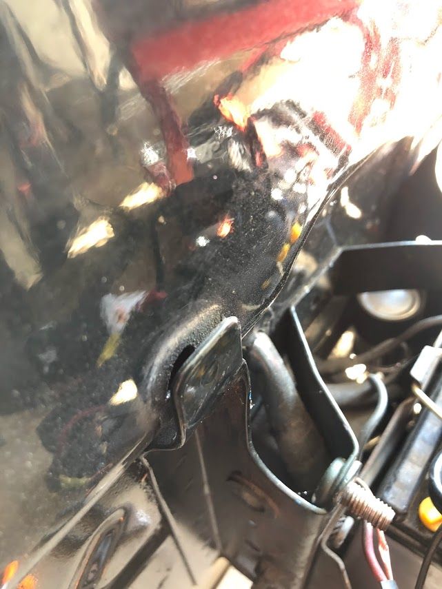

3. battery area bracket-on of the weld points popped exposing the approx. amount of the twist that i might now have on the body of the scoot
Let me know if I am seeing it correctly and if its fixable or the scoot is done...

You got smacked hard, for sure.
In addition to any frame damage, I'm guessing the fork is toast, the shift tube is bent along with other possible damage inside the headset, plus the kickstart, at a minimum. Crying or Very sad emoticon
In addition to Frank (whom I know of only as a guy who puts lots of bikes on craigslist), you could also look at picking up a cheap Stella, then put your motor in that and eventually use the fork to do a disc brake conversion once you have another Vespa frame.
