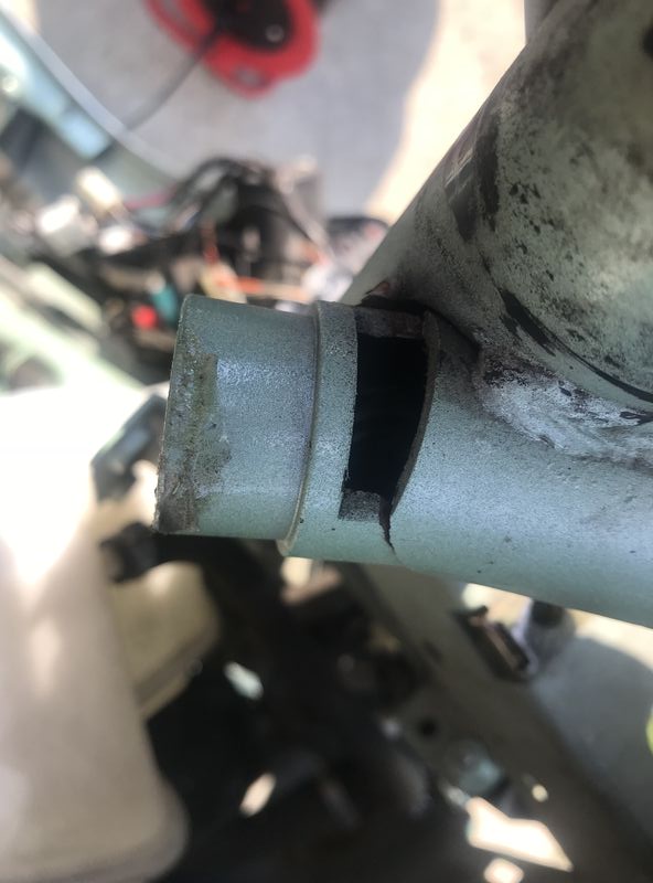

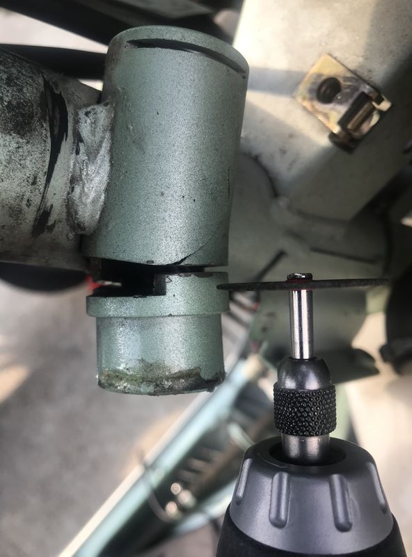

I recently purchased a 200GT with a salvage title. It has over 20,000 miles and and some cosmetic damages. I'm assuming it was previously stolen then recovered as the lock that attaches to the frame is completely cracked. The guy I purchased it from added a third party key to it allowing it to work with 2 keys (original must be used to allow CDI to work. I request help on the following:
1. I'd like to restore it to operating with one key has anybody had any experiences with cutting out the old fractured lock holder (the one welded to the frame) and replacing it? I've found the pieces at the SIP scooter shop. Just would like some insight if anybody has done it before.

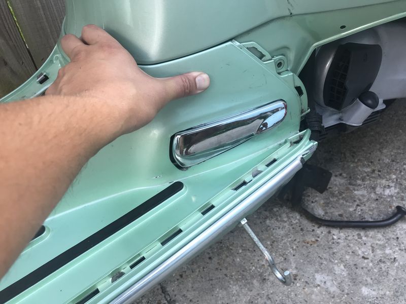

2. The flood boards are bent so much so that the passenger peg does not fully extend. Anybody have any experience with bending pieces back? Perhaps tack welding a pad eye?

You have to grind all the welds and take out the whole cylinder. Fit the new one and reweld it in place...

I've been using a dremel-like tool to lop it off but progress is slow and the angles are weird. Is there a different method or a different tool I should be using? I only have one weld left to get through but it's in a hard to get location.
Is fit up difficult? I'm assuming you tack in place until you get it just right?

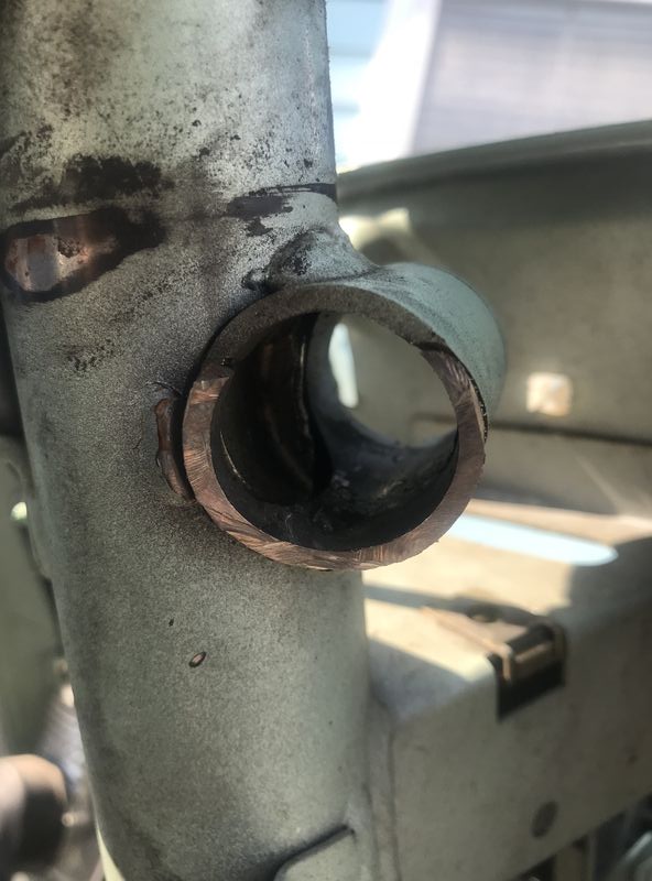

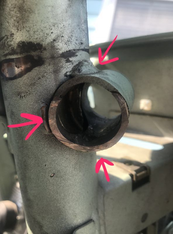

Day 2 Scooter log, Earth Date 30May2018:
Today's progress, finally removed the key ignition cylinder. New pieces and welder arrive next week. Very stoked. I'll clean up the previous weld once I get the new cylinder. The dremel tool came in handy today, probably the hardest test I've put it through. Took me three blades to take it off entirely.

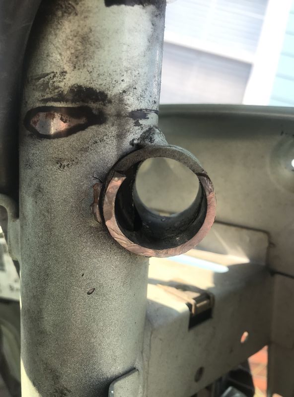

ignition cylinder removed.

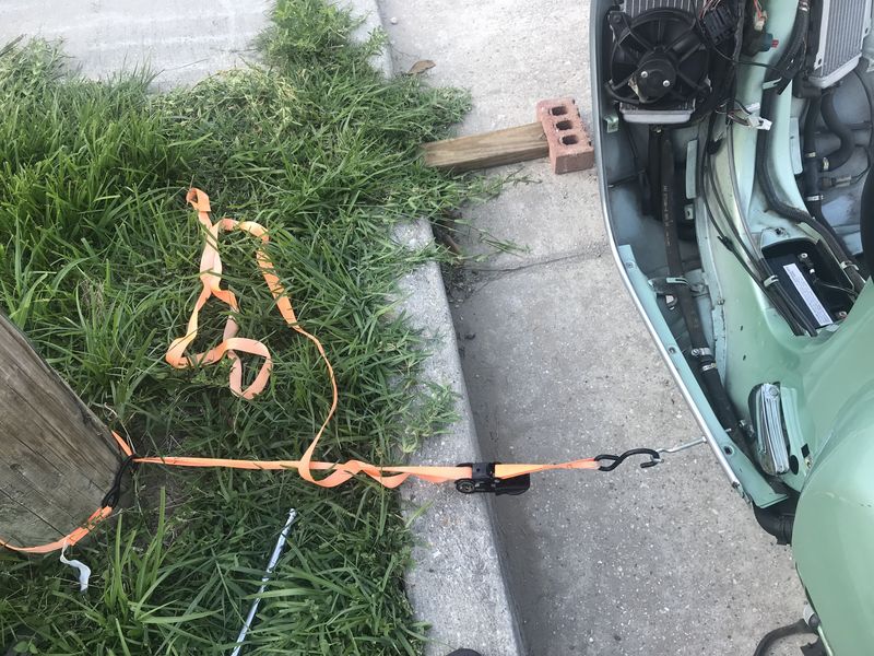

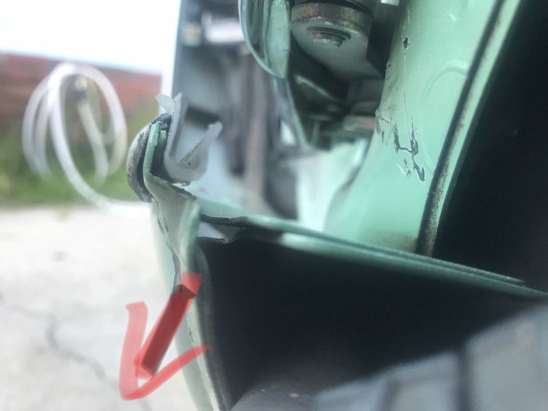

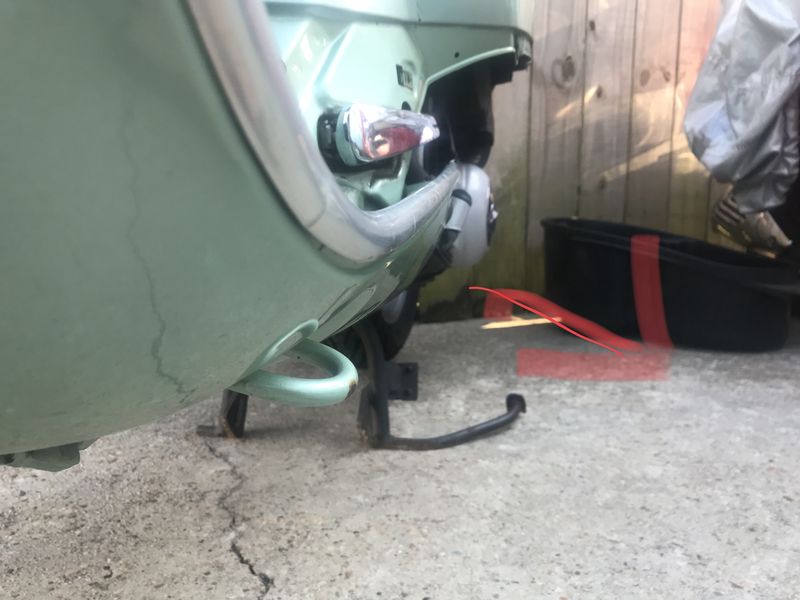

Any I ideas how I can bend the flood board back? It's bent about an inch inward on the port side.

After some thought I finally figures out how to bend the floorboard back to the original position. I had to get pretty creative. Initially I was going to weld a couple pad eyes to the board then ratchet it down, this was less intrusive and worked perfect.

Great work and very creative in your frame straightening methods. Who knew a telephone pole and bricks could be used for bodywork.

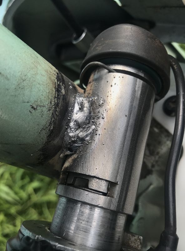

I got kind of desperate! Had to get creative. I finished up my weld job this morning. Pics this PM.

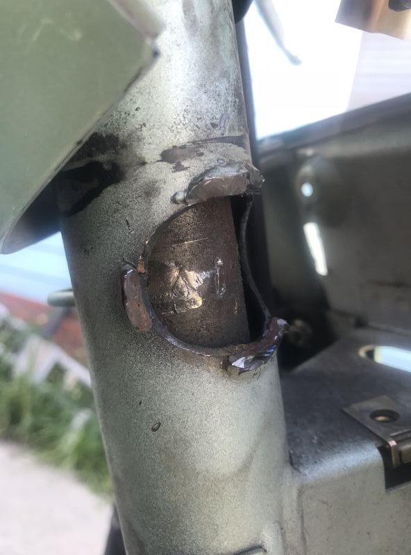

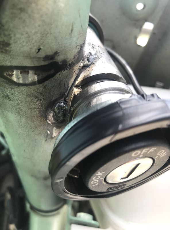

Did some heavy lifting today. Got the weld machine in practiced laying down some beads. Took a bit to get used to, I'm looking forward to more projects where I can use it. The ignition cylinder went in nicely, I was kind of worried about getting the right amount of power to get good penetration. Here are some shots of the finished product. Not the prettiest but they hold well and are aligned.
