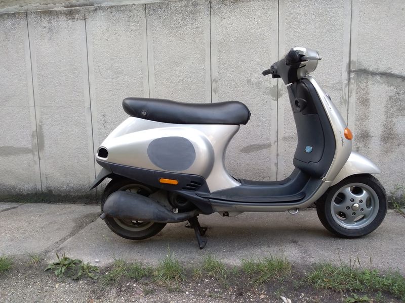

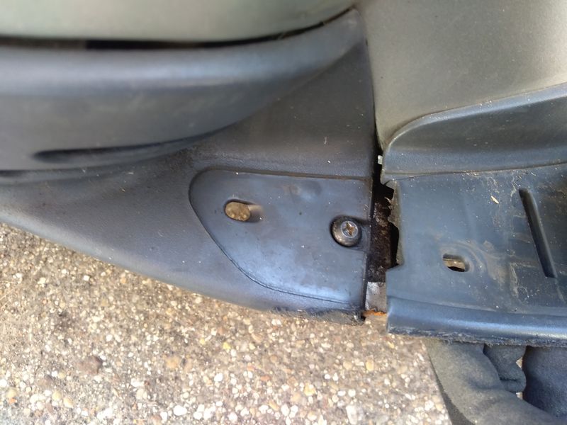

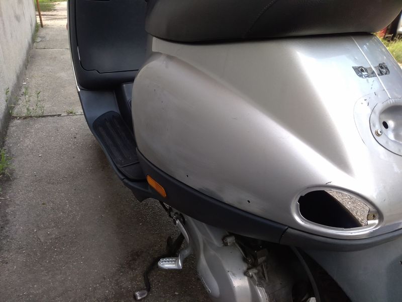

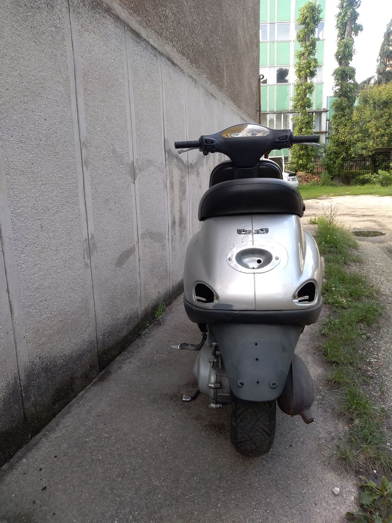

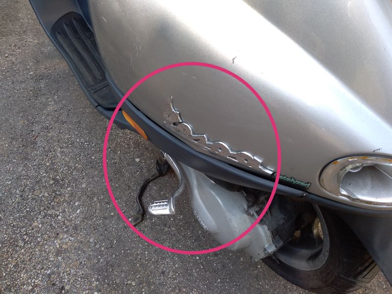

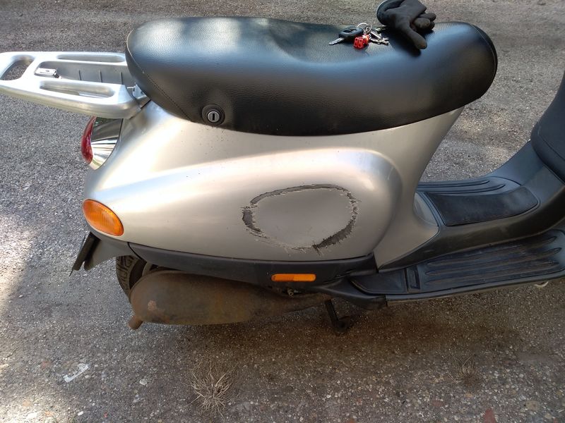

I had an accident.
Accident
Yesterday I started to repair the scooter.
Problems:
- dents and scratches on the body
- broken turn signal cover

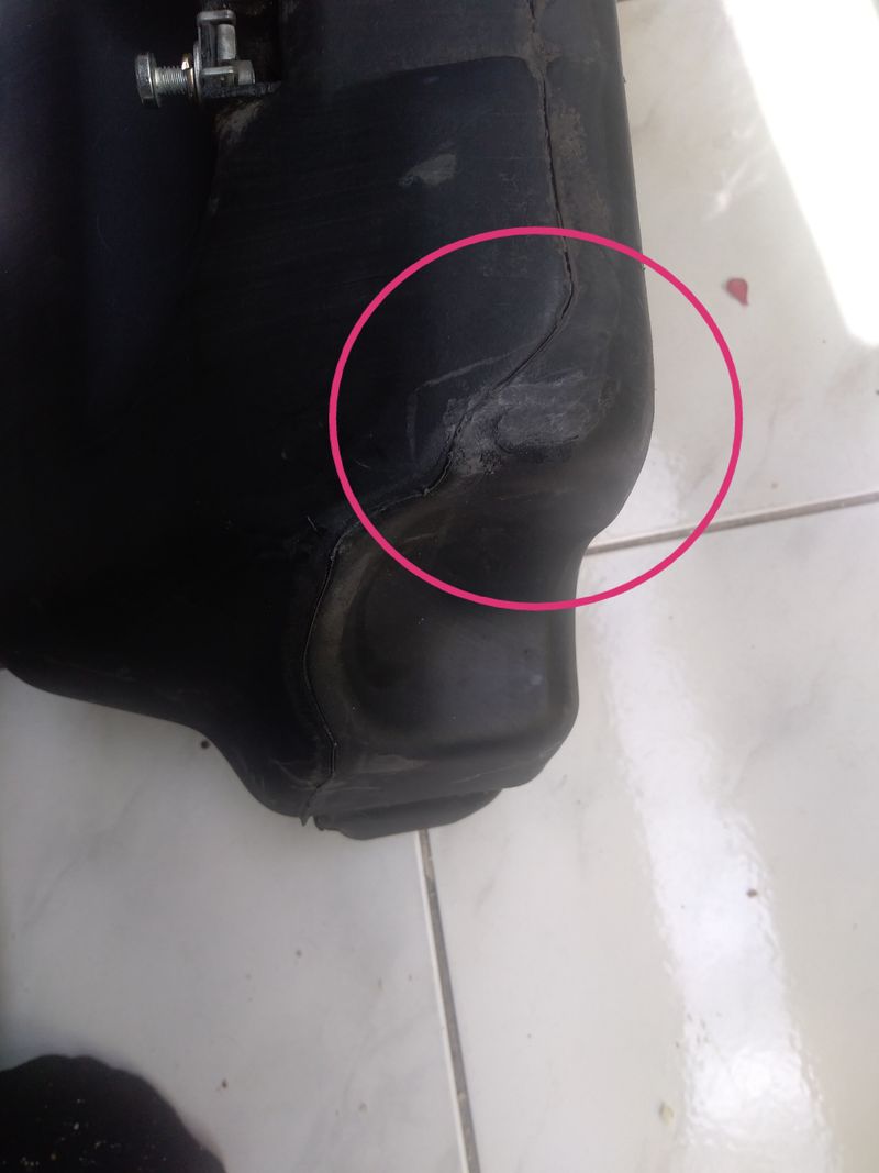

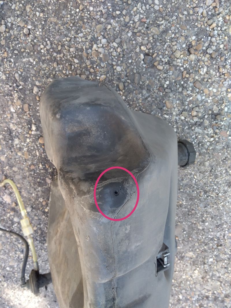

- a little hole on the fuel tank (made by the screw of the turn signal)

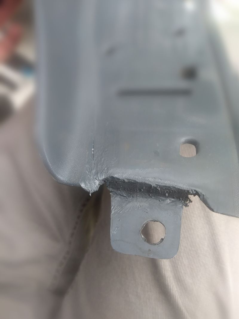

- broken footrest plastic tab
I can't do the bodywork, I am going to take it to a pro. I don't have money to repaint it, I am going to do something (plasti dip or decals).

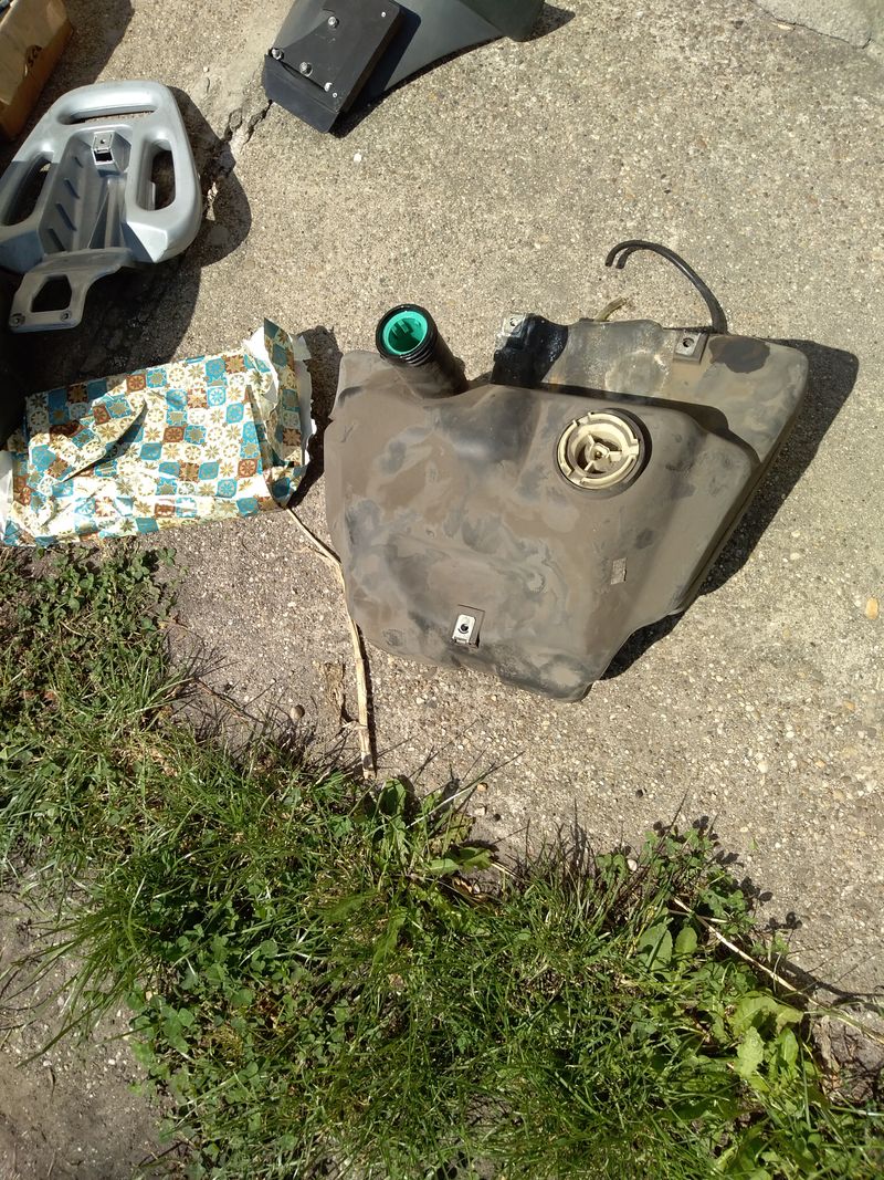

But first, I removed the fuel tank. It wasn't as easy I tought, but finally I won. (If someone need advice about it, I write the procedure.) The hole is very small (~3 mm), I'll buy a specail glue (gasoline resistant) to do it.

Some pictures

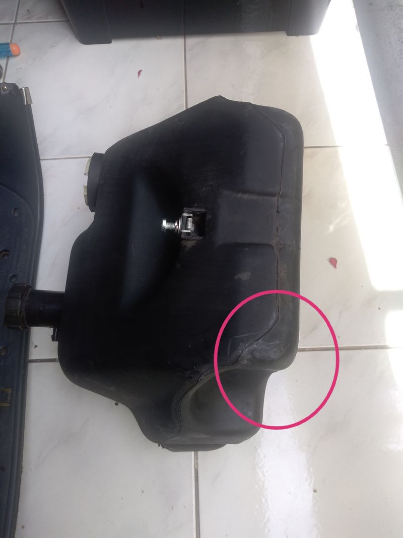

Lord Ickenham wrote:
I'll buy a special glue (gasoline resistant) to do it.
Tank is polyethylene, might find something that will adhere mechanically but wouldn't trust to be leak free. Plastic welding best for poly.
Thank you. In auto-repair shops there are epoxy for fuel tanks. What do you think about it?

Google search. Polyethylene is a "low energy" plastic and doesn't bond well. While there are special adhesives most recommendations are for thermal repair.

Thanks Mr. Google! Clown emoticon
I am going to follow your advice, I found a plastic welder company.
Thanks!

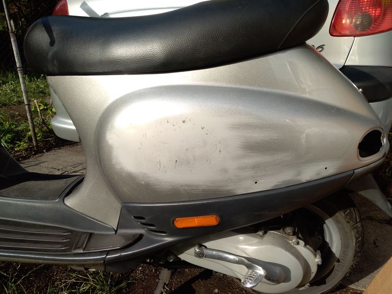

I don't have enough money to a pro paint, I'll only pay for bodywork. I have two ideas:
1. I'll use plasti dip on the sides of the body.
2. I'll put a colourless protection on the dent and scratches, and I put a funny sticker in the middle of the scratch.

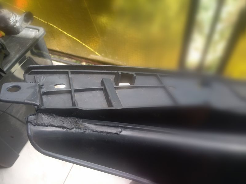

I am here again.
I took the broken plastic parts to a plastic welder. Tomorrow I'll get them. After tomorrow I'll take the scooter to the body repair shop. Today I removed the air filter pipes and the oil tank. I cleaned them and the scooter too.

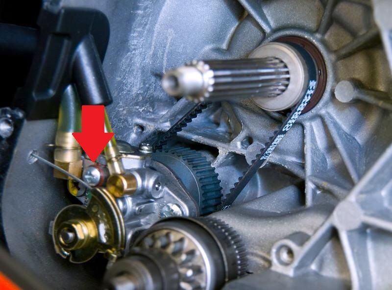

Don't forget to bleed the oil pump when you put the tank in again...
Oh, thanks! It is a very good advice! I didn't think about it.

It's really important cause a small air bubble will stop the oil going to the pump resulting on seizing your engine. You just have to unscrew the pointed screw in the picture and let the oil drip until there is no more air...

Yes, I've done it earlier. I have a silly question: when I know that there is no more air in tube?

You won't see any more air bubbles coming out from the hole...
Great! Thank you!

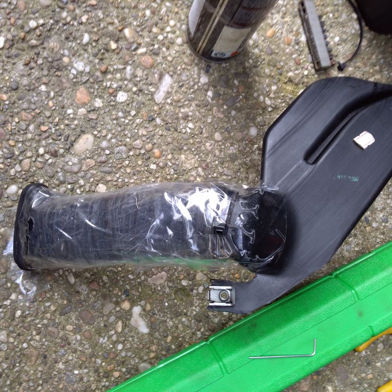

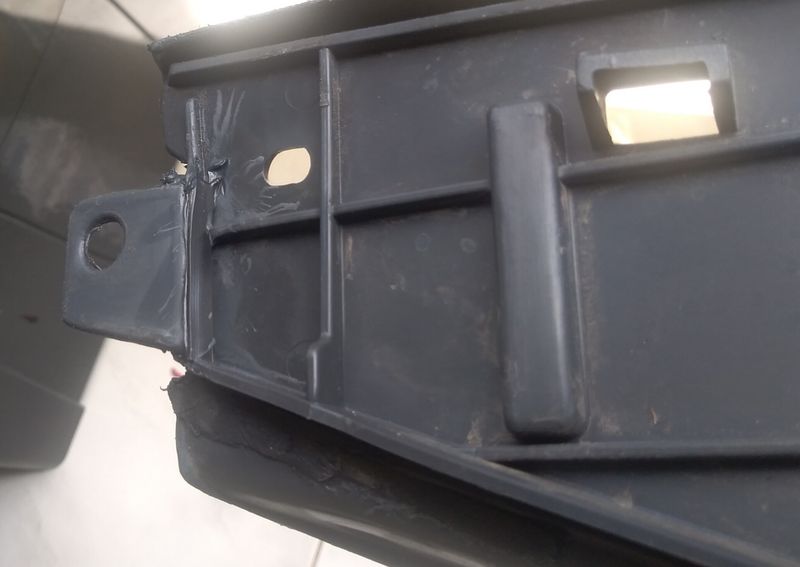

The plastic parts are ready. The hole on the petrol tank totally disappeared, and the broken tab is nice too.

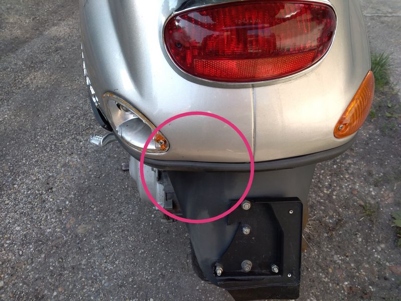

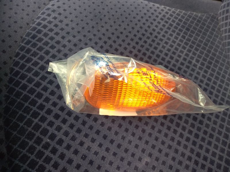

I bought a new rear left flasher, because it's broken. Yesterday, me and my brother-in-law took (he has a van) took the scooter to the body repair shop. The bottom of the scooter curled a little bit, they'll fix it. The master said, the price is about 145$.
@lord_ickenham avatar
et 2 50cc
Posts: 828
Location: Hungary
et 2 50cc
Posts: 828
Location: Hungary
It's ready!

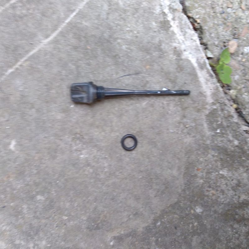

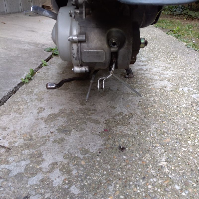

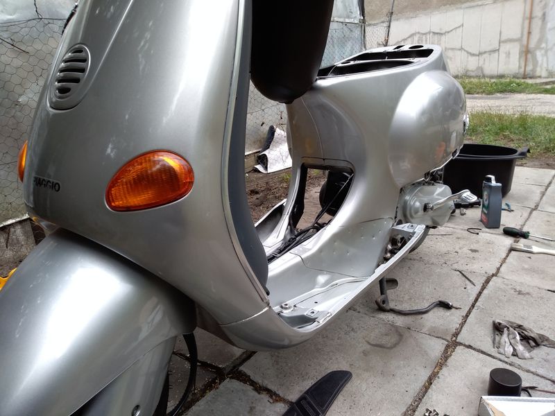

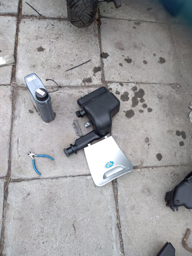

Now, I've arrived again. During the recovery work, I do some maintenances, too. It isn't so easy, because I don't have garage, I work on the backyard of our apartment. It was the time to change my old Pirelli tyres. I bought Metzeler 7-teen. I changed the gearbox oil too (I know, some guys here don't believe it is important, but it is my dirty pleasure).
Reality show for neighbours
It has a good smell
It has a good smell
I changed the o-ring, because the old sweated the oil
Gearbox oil change is easy without the wheel

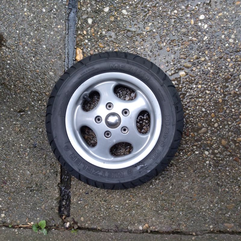

I put the wheels back. But, tbe front wheel blocked. I tought, I made a mistake when I cleaned the front brake. But I did not. The guys at the tyre shop made a wheel truing, and glued 2 little metal plates to the wheel (I took only the wheel to the shop.), but these stucked under the caliper.

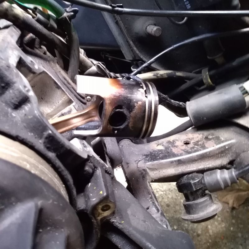

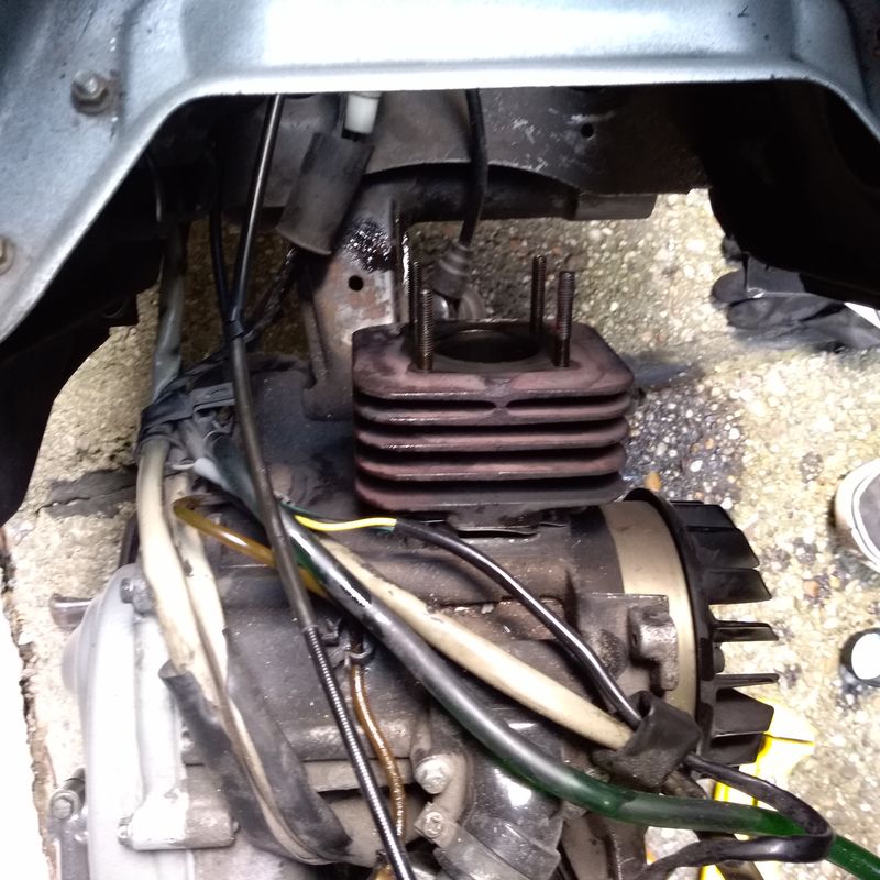

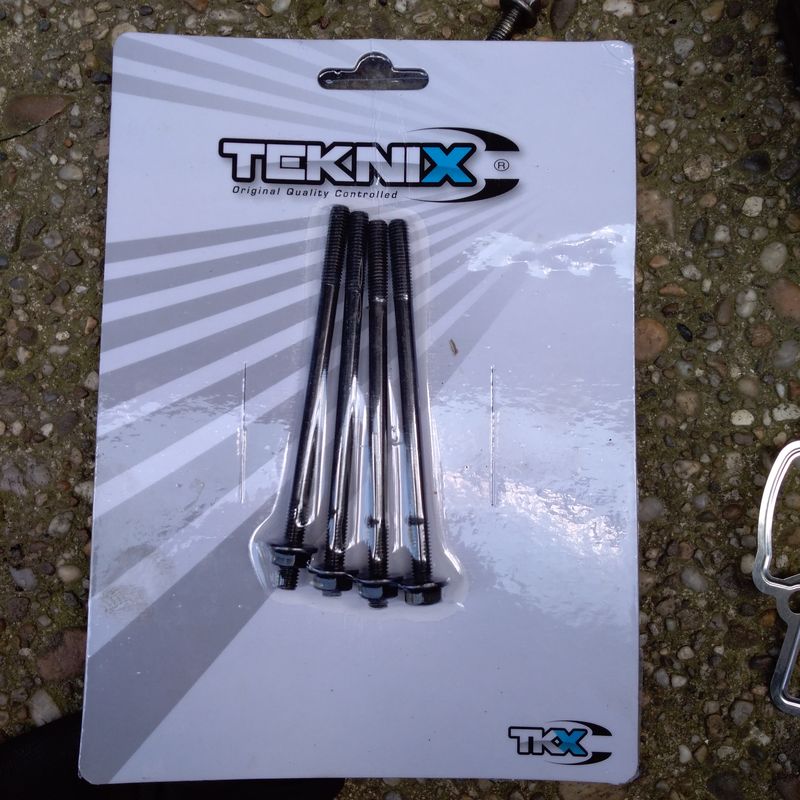

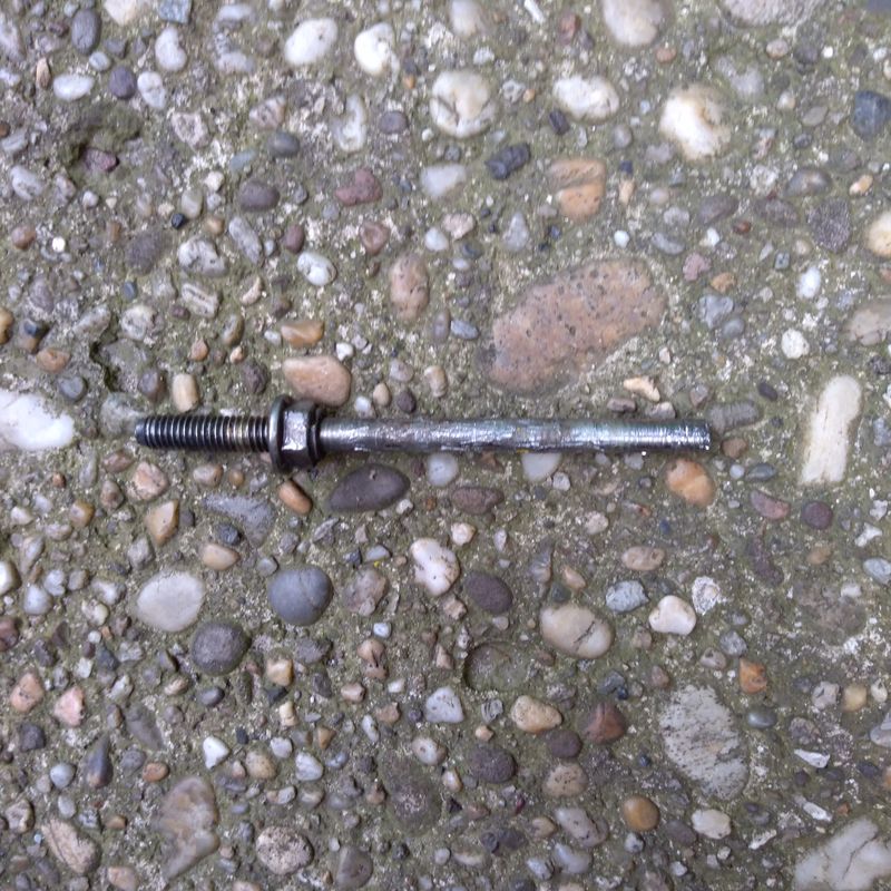

Help! Broken stud
I tried to remove the broken stud, but I couldn't. I didn't find any good lock pliars, then I bought a huge water pump pliar. Successfully removed the stud. Then I put back the cylinder. I didn't brake the rings (huhh), then I applied the new studs. But, I was an idiot, I broke one of the new studs. My torque wrench starts from 19 Nm, but the nuts need 15. I used 19. At least I could change the broken stud very fast.
Now, the engine is ready, I have to put back the air-filter, the air-filter hose, etc.
My new favourite
My new favourite
The little bastard
The little bastard

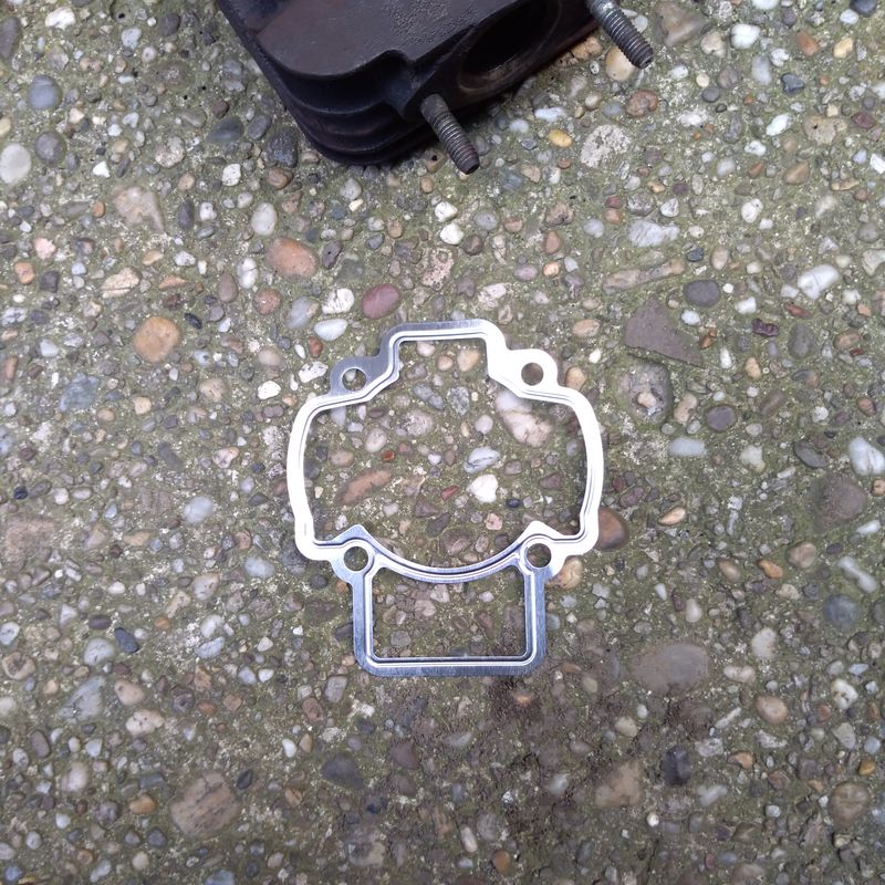

Brand new gasket
Brand new gasket
Studs
Studs

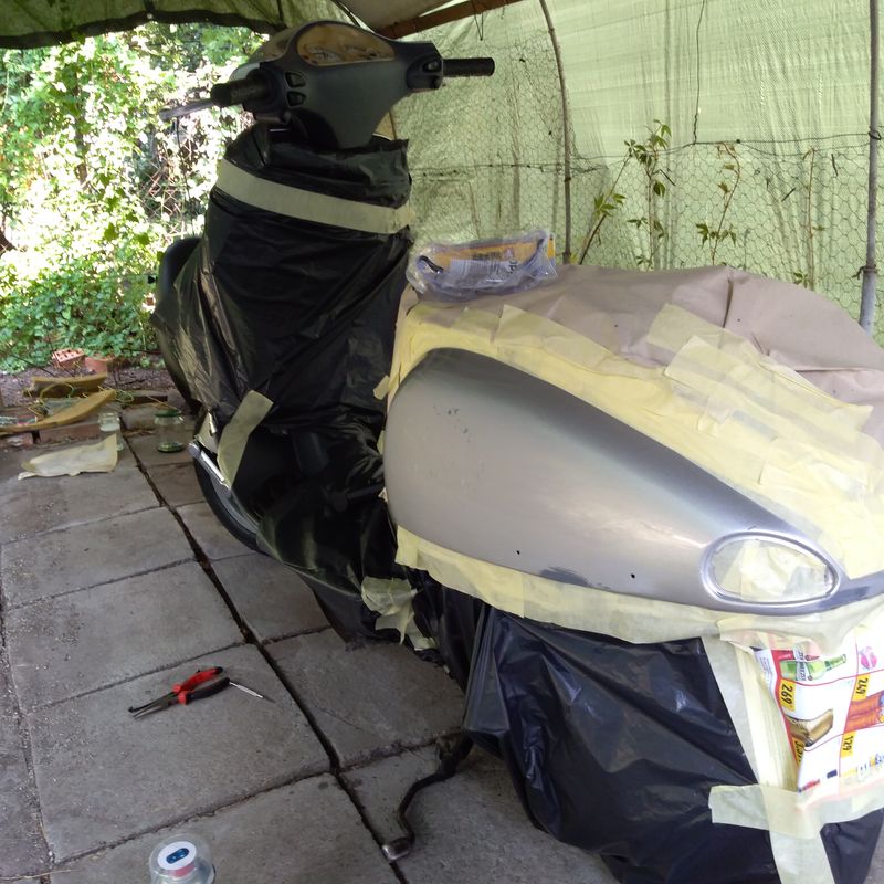

Masking
First coat must be light

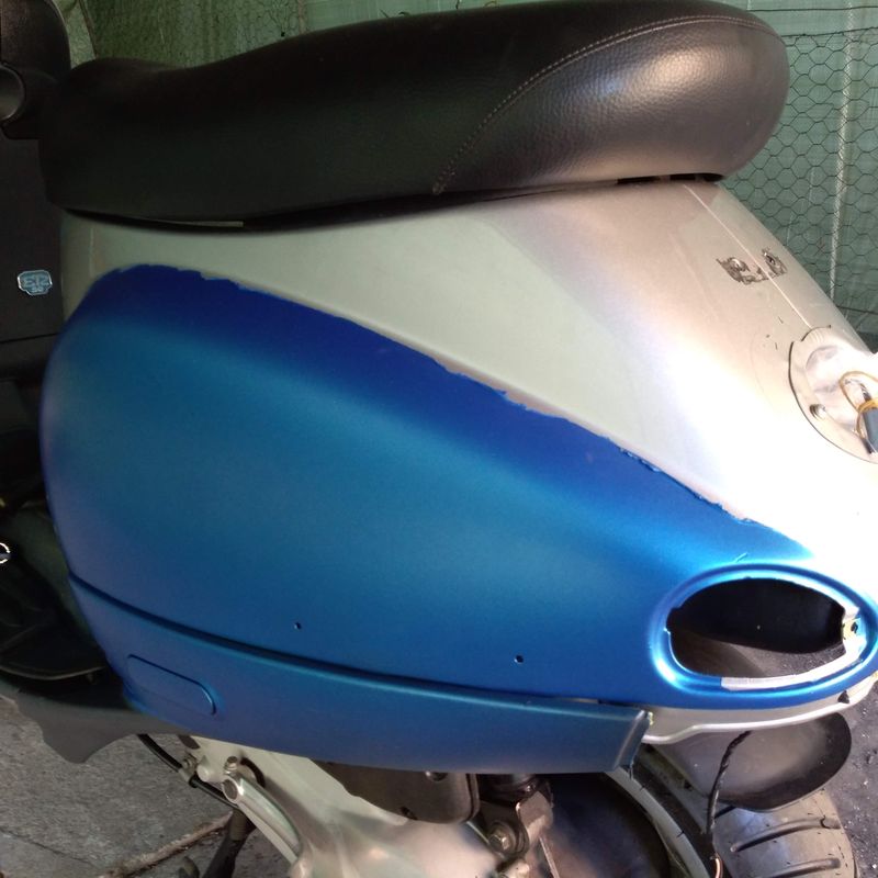

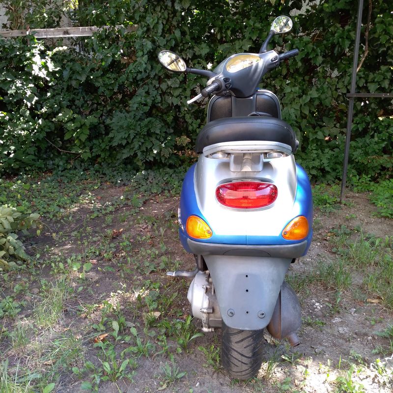

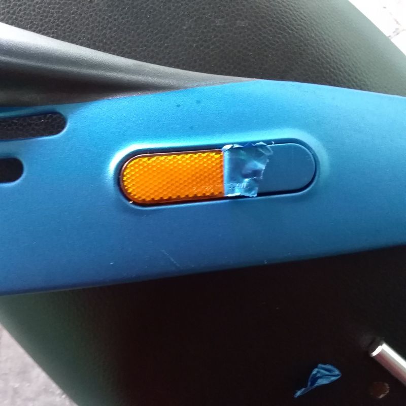

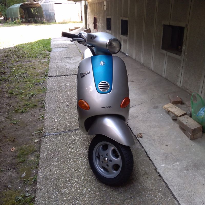

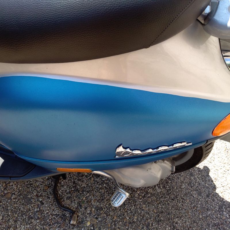

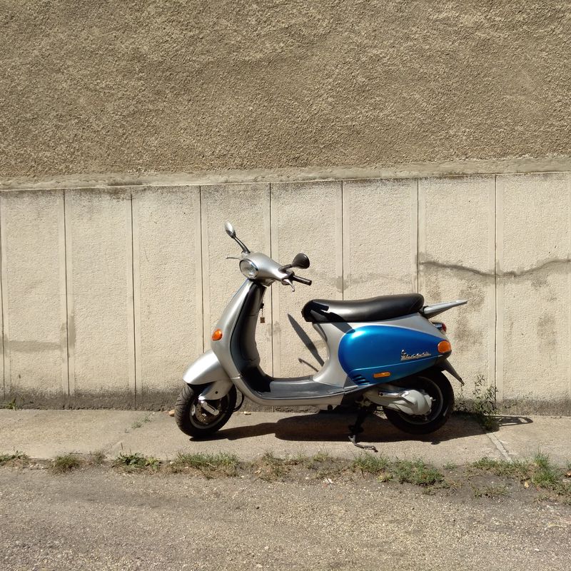

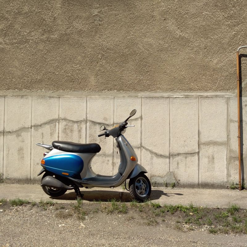

At last it is (almost) ready. Yesterday I painted it with plasti dip. I sprayed ~8 coats, but I waited a little bit more between the coats (it's written 10-15 mins., I waited sometimes 20 or more. It was nice, but when I removed the masking tape, the edge of the dip came with it. I tried to make it nicer with a hobby knife. Not perfect, but next time I will be more professional. The new speedo cable went crazy, maybe there is a problem in the connections. But at least, I am riding again. 3 months without scooter. Brrrr.
Last time, when I changed the rollers, I bought 6,5 g. Now I use the previous rollers, because these weren't bad. 7,5 g is the best.
Oh
Oh
Not perfect, but better
Easy to remove
Easy to remove

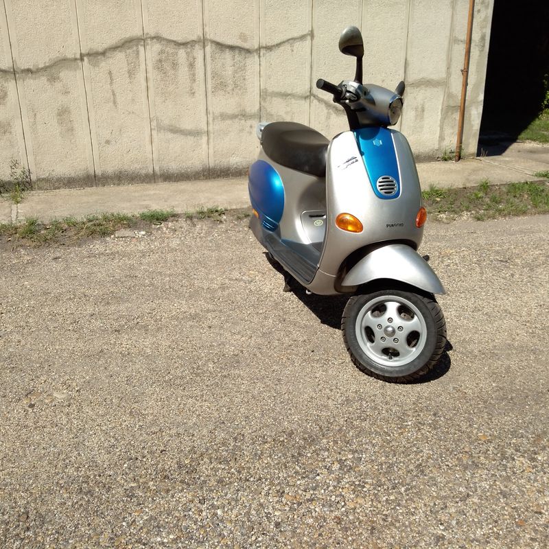

Changed the old battery.
Cleaned the air filter and the carb.
Painted the horn cover and the two sides of the body.
@berto avatar
2018 Liberty 150
Posts: 2092
@berto avatar
2018 Liberty 150
Posts: 2092
Well done! Congratulations on getting her back on the road!!
@joeszymkowicz avatar
2004 Vespa ET2
Posts: 18
Location: St. Louis, MO
2004 Vespa ET2
Posts: 18
Wow great recovery. Looks good.
