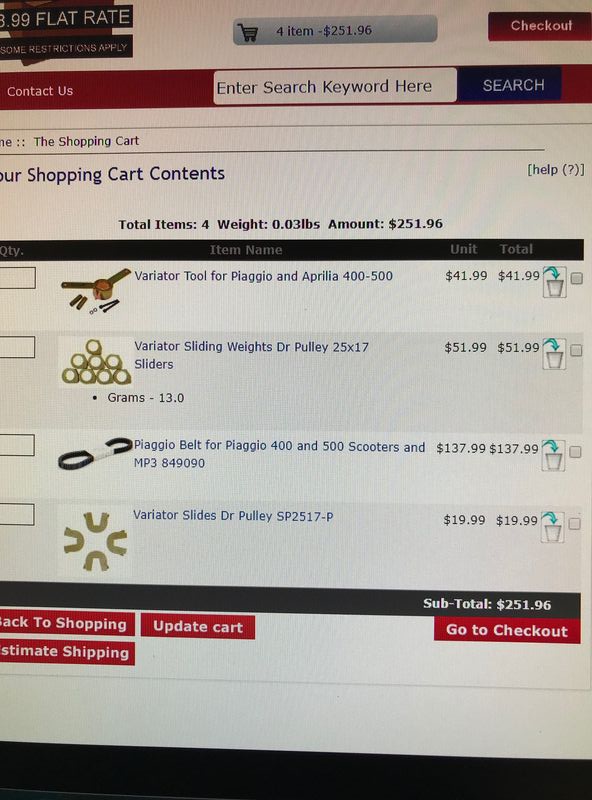

Am I missing something?

yes 13gr are much to light go for17
What's the best weight?

Std weights for the 400 are 19 gms after 09, 21g before. What do you want to achieve?
16 would be the lightest for a standard 09 or younger bike. 17 to be conservative. Maybe 16.5 as a compromise. But again you have to be clear what you wish to achieve.

AETERT wrote:
Sorry I see you mentioned 17 now
Better power off the line.

AETERT wrote:
A side effect of lowering the gearing slightly will be increased engine rpm before the clutch engages which will get you more into the power band. Then the lighter weights will keep the motor there.
You may experience increased rpm during cruising but that is just the ying and yang of the mods.

ScooterPartsCo.com
I spoke to a very helpful man at this website. Does anyone have any experience with this site? He didn't have great things to say about the sliders. But recommended the Malossi 14 gram rollers. And feels like my shutter and squawking noise can be solved with a new Malossi Spring for the clutch. Any thoughts??? Nerd emoticon

Scooter Parts is a good company.
Many of us here (including me) use the Dr. Pulley sliders. Their design is proven. I have heard people who have ran them for thousands of miles with no wear at all. The design/function of the sliders is superior to rollers in my opinion.
Also as I and others have previously told you, 14 grams is going to spin that motor like crazy. 16 is the absolute lowest I would go and I run 17's which perform great in all conditions. There are many threads on this forum that you can search to get more information.

14g rollers are way to light. I have Dr. Pulley sliders in mine and I really like them. Mine came with (I think) 25g rollers and I went with 21g sliders and it was a really nice improvement.
