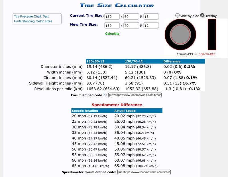

I know we as group have discussed it endlessly, but I have the 13 inch wheels on my bike and scootewest tells me that if I go back to the 12 inch wheels my acceleration will improve. How is that possible when the diameter of both is roughly the same (about 2mm difference)?

Did you explain to them that the diameter of the tires is nearly the same?

Yes I did and the response;
"Yeah, I don't know why but the 13s make the bike feel flat"
Now to be fair, I find the 13s to be more stable I suspect due to the shorter stiffer tire side wall but I don't understand how that will affect acceleration given the similar diameter?

If anything, all else being equal, the 13" wheels could make for faster acceleration because of their lower moment of inertia, if there's less heavy tire rubber at the outer circumference of the wheel.

Reduced inertia with 12" wheel/tire combination.
+1
The aluminum of the wheel is heavier than that part of the tire. Smaller wheel = less moment = better acceleration if the overall tire diameter is equal between the two.

As the guys are saying, the 12" wheels offer better acceleration, even although there is only a tiny difference in overall wheel circumference (the 12" being slightly smaller). The smaller size lowers the overall gearing of the final drive. The 13" wheels raise the overall final drive gearing and can affect top speed, and depending on how good your motor is, it may slow you down on top speed or actually give you a tiny increase in top speed. Generally, unless you have tuned your motor 12" wheels offer the best performance.

It's the lower stiffer tire side wall that makes the difference in the "feel". The tires are 130/60 13" vs 130/70 12"

There appears to be 3 things wrong with this project...
1. The shiny metally bit of the wheels have a different DIAMETER O.D. in their size (13" vs 12")... therefore don't match in SIZE
2. The black rubbery bit of the wheel is a different DIAMETER I.D. in their size (12" vs 13")... therefore don't match in SIZE
3. The 2 completely different tyres have the exact same folia good distance ( they take the same REVOLUTIONS over distance ... ie the O.D. Or Circumference of the black thing are identical, therefore will have NO EFFECT on speed nor revs, not anything else for that matter
https://www.tacomaworld.com/tirecalc?tires=130-60r13-130-70r12
The rate of angular acceleration will be impacted by mass, and where the mass is. Assuming the two setups have the same mass, the larger diameter wheel with its corresponding larger diameter tire bead will put mass further out from center, resulting in more torque being required for the same acceleration. If the 13" wheel is actually heavier, it will only increase the difference.
As to the comment about the 13" wheel feeling more stable, if its mass is at a larger diameter it would have stronger gyroscopic effect.

While I agree with Sully's reasoning in theory, in practice the inertia of the scooter/rider combination is so large compared to that of the rear wheel as to render the latter pretty insignificant... except perhaps for the difference in the gyroscopic effect.
Also, with the minuscule 0.1% difference in the tire circumference, you'd need one helluva well-calibrated butt dyno to detect any performance difference due to the difference in overall gearing. A bit of tire, belt or roller wear would likely overwhelm any theoretical difference.
