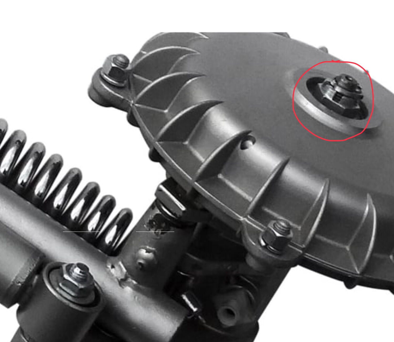

Apparently the attached sheet should have been in the box. I think it says I need to pull out the grease nipple and fir a rubber stopper (none in the box) in its place.
Anyone able to point to a good thread (with pictures for this slow learner) showing how to pull a Sprint/Super front hub apart and put it back together? And/or how to do the same with the spring (Pictures ditto...)
I promise to sprinkle this thread with install photo's in return (f I can figure out how to route the brake hose)
Craig
Grease fitting out, rubber bung in?

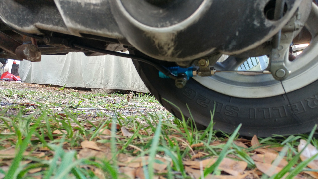

I'd like to see a linked setup with drum rear. Maybe have a hydraulic cylinder that mounts underneath and pulls on the rear drum cable?
@chandlerman avatar
Innovator
Posts: 12077
Location: Nashville
32 Days Since Last Explosion
Innovator
@chandlerman avatar
Posts: 12077
Location: Nashville
I was looking at playing with a hydraulic clutch and lever.
You could do a rear brake the same way, but you'd have to figure out how to connect the master cylinder to the brake pedal. I have thoughts, basically mount it to the side of the tunnel like the brake light switch, but nothing solid until I get one to look at and can figure out how what you would need to chop off and then add mounting bolts.
Crimaz did try that, it was a couple of years ago so I assume he thought there was not much call for it. Uses discs both ends. His method was... kinda crude you might say, but he said it worked well. Just run both calipers off the same master cylinder, no biasing or anything. Or rear only via the pedal. There's a video here -
Cristian Crimaz Mazelli wrote:
Sneak peek.
Front disc rally rally Largeframe rear disc disco p & p pump, the result is amazing.
In the rear drum remain the original jaws operated by the standard pedal.
The right handlebar lever operates both pliers simultaneously
https://www.facebook.com/cristian.mazelli/posts/2288084504540331

I have aired the system at my best. Any suggestions on what to do? Thanks
your problem resides at the master cylinder.
when your hand moves lever the fluid cant move backwards. pressure is created which pushes pads into disc. when lever is at rest the fluid is able to move backwards back into the master reservoir. first thing to check is to be sure lever is not allowing the cylinder to return to rest position. simple to remove lever to see if drag disappears. if drag is still present the problem resides in the master itself.
I just had this very problem when I purchase ebay masters for my helix project. I eliminated foot brake by converting rear cable brake to hydro. I wanted the masters to match. the ebay masters did not allow fluid to return in the rest position. I had huge brake drag problems. in my case they wouldnt drag immediately. the more you drove it the more they dragged. eventually locking the brake entirely. had to carry bleed wrench around on rides till I figured out where the heck the problem was. problem was solved by switching to factory yamaha masters. the return hole is very small and very close to first seal. I didnt want to spend the time removing guts of cylinders to modify.
side note: the drum brake converted to hydro is very powerful. very pleased with conversion. can lock rear brake from 40mph with ease. you will have to match master cylinder size to slave cylinder size properly. there are numerous sizes at both ends.

I actually looked at doing a hydraulic conversion for the clutch on my GL project this way.
JerryD, I know you said you did it for a Helix, but how much pain/work/trouble was it to do the basic install and setup?
Posts: 1001
Location: tampa
Posts: 1001
Location: tampa
my info is useless as far as how hard it would be on a vespa. it was easy mod on the helix. re-used ,reshaped original cable bracket for mount. ordered correct length line. my main point was how good drum brakes are when hydro operated. if I ever find an early vespa worth owning I was planning to convert both drums to hydro . its inexpensive compared to disc brake conversion.. drum brakes work far better than people give them credit for. they just basically suck when cable operated. there isnt proper leverage. drum brakes are also known to not work well if water gets into drum when raining. wasnt an issue on the helix. still has great power in the rain the few times I had to drive in it.
I could data on cylinder sizes. but if you plan to operate both front and rear with one lever all that changes as well.

Hello,
I have a front system (fork), where I install crimaz disc brake. But I have an issue. I put the drumstick, the washer and then the nut.
The tighter I tighten the nut, the tighter the drum gets and it doesn't turn. Do you have any idea what it could be ?
